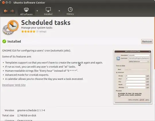

Install Scheduled Tasks:

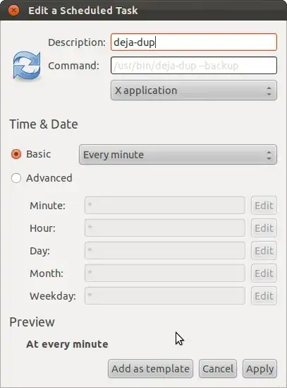

Add a job to it with the following parameters (replace every minute with every hour or the schedule you want to use):
You can even hide the pop-up window by using deja-dup --backup --auto as the command or use X-Application: suppress outup in the default behavior drop box, it will hide the window while deja-dup runs.
