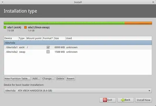

When the partition part of the installer starts - choose Something Else
This will then show you a list of your partitions, you say you only have one partition for Ubuntu, this will show as a linux partition, there will also be a linux-swap - you can ignore that. Ignore the NTFS partition.

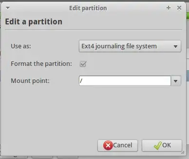

Select the linux partition - then select the Change button underneath the listing
In the new window - Use As Ext4 - mark for formatting, and use / for the mount point.

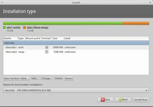

Exit that back to the partition listing, check there is a tick mark in the Mount point box against the partition and carry on with the install.
