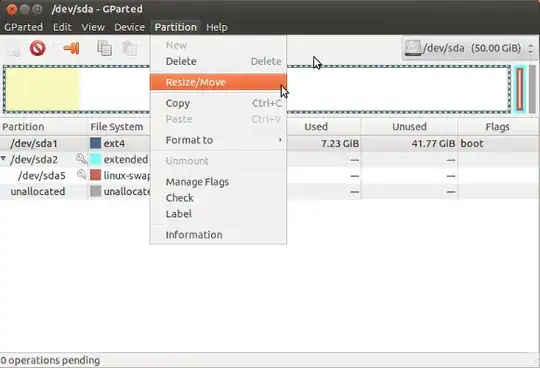

  • Select partition to shrink
    Click on the partition we want to shrink (take extra care that the partition is really the one we want to change). Then choose Resize/Move from the Partition menu:

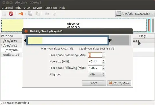

  • Define size of the new partition
    In the window that opens use the mouse to drag the right side of the partition to the desired size or give in appropriate values in the textboxes below:

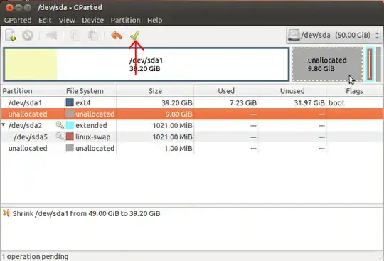

  • Apply changes
    We can now go further to step 3. below to create a new partition formatted as NTFS or we apply these changes to leave part of the disk unpartitioned:

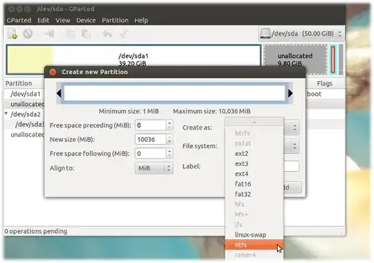

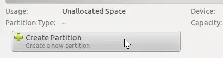

3. Create a new partition
In case we have an unpartitioned space on our disk we can partition ii with the disk utility or run gparted Install gparted (we need to install it only when we are not running a live session) to select the unpartitioned space. From the right click menu choose New:
Select ntfs (or any other format) from the File System dropdown menu and optionally choose a sensible label for this partition. Click the green tick to proceed.

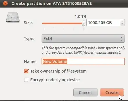

yes you can
open disk utility to create new partition ,and chose either ntfs or fat as the partition type
1. click on the create partition button
**2.chose ntfs or fat in the type and press create button **
