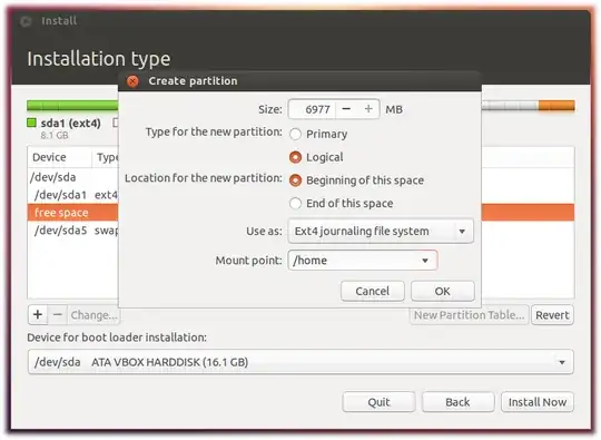

  5. Repeat step 3. and 4. for the /home partition:

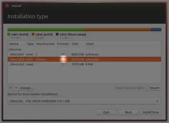

    In case there is a pre-existing HOME partition holding data we now have to make sure to untick "Format?" before we proceed with the installation to not delete this data:

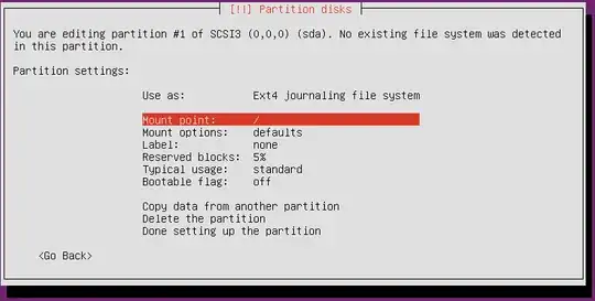

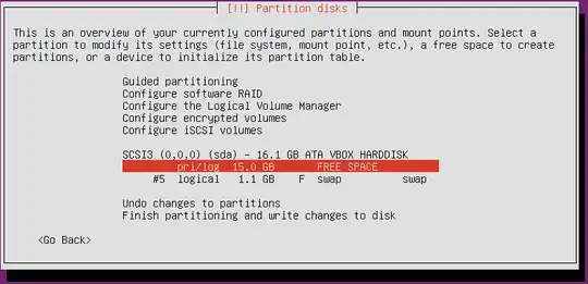

Ubuntu Server installation

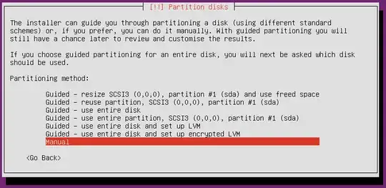

The server installation will guide you through the partitioning using partman. At the partitioning step we may delete, or create new partitions similar to the desktop installation. Shown below are interim steps when we do so:
  1. Choose "Manual" partitioning for an individual setup:

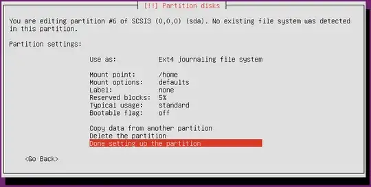

  2. Choose partition to change or free space to create a partition

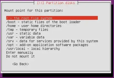

  3. Select mount points / for root or /home for HOME:

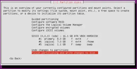

  4. Repeat steps 2. to 4. until finished:
  5. Continue server installation:
