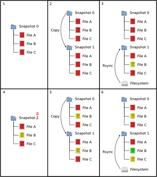

To explain cprofitt's answer (as his answer is incremental, as I will explain)...
First you need to know about hard links.
Hard links point to the data that is actually on the disk (the physical location) and you can access the data using the hard link. Each file and directory is a hard link to the location of the data on the physical disk. Therefore if there are two files (hard links) pointing to the same location then the data is only stored once.
The process given by cprofitt involves:
  1. Rotate the backups to create a spot for a new one. ("Today's backup" from yesterday becomes "Yesterday's backup", "Yesterday's Backup" from two days ago becomes "Two Days ago's backup" and so on)
    • The list keeps growing as long as you want it, however in the script it only has 4 snapshots. (It does the whole process again for the next level (e.g. a week - "This week's backup") and rotates those, so that is why it has only 4).
    • The moving is done in reverse to prevent overwriting
  2. Copy the latest snapshot you have done (e.g. "Yesterday's backup") to the spot for the new one (e.g. "Today's backup"), making new hard links to the existing files without copying the file. So all the files in the new snapshot are pointing to the same location as the previous one.
An illustrated example
In the picture below, files of the same colour that have the same file name are hard links to the same file on disk. Here we are just dealing with two snapshots and a few files, but the example scales. (Except for the fact I am moving snapshots the opposite way to scripts in cproffit's answer)
The process is this:
  1. There is a snapshot of the system.
  2. The snapshot is copies (creating hard links to the existing files)
  3. Rsync is run to update the snapshot. When files are changed, it stores the new file as a new copy on the hard disk (so the older snapshot is not changed). In this example, File B has been changed. Note: we now have only 1 copy of File A and File C and two copies of File B stored on the hard disk
  4. Rotate the snapshots (in this case snapshot 0 'falls off' and is deleted and I rename snapshot 1 to snapshot 0)
  5. Copy the snapshot agin (repeat of step 2)
  6. Rsync again. (Repeat of step 3). Now we have 1 copy of File A and 2 copies of both File B and File C

There are 2 ways to do block based incremental backup
  • Filesystem based snapshots
  • Program based snapshots
Both ZFS and BTRFS provide block based incremental snapshots (BTRFS, ZFS (page 25)). You could have a drive that you rsync to that is either ZFS or BTRFS and snapshot.
There is also LVM snapshots (mentioned by cprofitt) that provide the same block based incremental snapshots.
