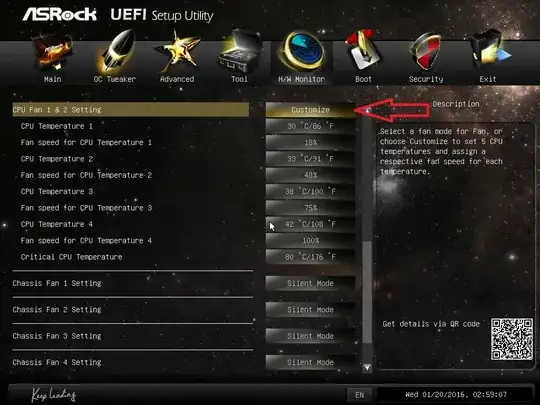

Try looking in the UEFI setup (or BIOS setup) of your PC. There might be a setting for fan control where you can put your fan into Silent Mode, Performance Mode, Full Speed, Customize, etc.
How to access the UEFI settings: Reboot your PC and the key for entering them will likely show up in one of the corners (e.g. Press F2 to enter UEFI setup)
ASRock UEFI setup for fan control
