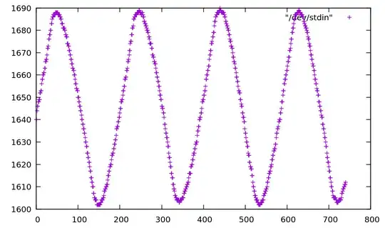

Before suspending it's all nice and calm, and the fans react nicely to the cooling requirements. However after resume the motherboard fan starts running with a sinewave pattern, at about 0.25Hz. Audibly it's an "ooooEEEEooooEEEEoooo" sound.
Graphing that fan using lm-sensors and gnuplot shows the almost perfect sinewave form of the speed changes:
I've seen plenty of posts that talk about fans being full on after resume, but never anything with this bizarre kind of pattern. It's like the hysteresis of the fan control goes completely out of whack and it's reacting almost immediately to the smallest of changes, and effectively oscillating.

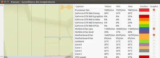

Same problem with a T5500 BIOS A02, ubuntu 16.04. On wake up, the motherboard fan pulses and wins 500 rpm compared to normal state. enter image description here

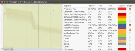

On normal use: enter image description here
