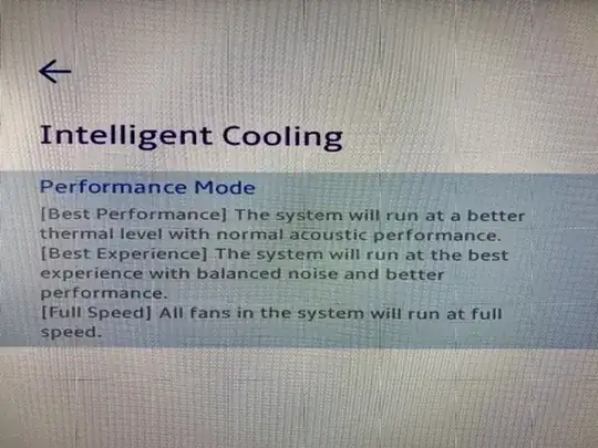

I suspect you cannot control it at OS level regardless of Windows or Linux, and your only control is at boot (BIOS). That is based on the following posts: https://github.com/vmatare/thinkfan/issues/95 and several others on the Lenovo Users Forum
bios
The ThinkCentre M70s doesn’t seem to let the OS control the fan. It is set statically by the BIOS. Very smart indeed!
