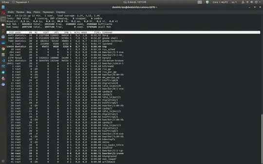

Every time that I try to run youtube, any browser, turn on nginx or mysql, the overall temperature of my hardware increases to 60-88 degrees C°. Sometimes it reaches critical value of 90+ degrees. To prevent that I have installed a brand new CPU cooler, external coolers, renewed the cpu/gpu thermal paste, removed the dust with air duster and still no effect.
Some info:
  • Lenovo G570(notebook)
  • 6GB RAM, preload feature turned on
  • top output below
Is there a way to increase fan speed with CLI to 100% speed when I need it? Are there any other ways to decrease overall temperature of my hardware (except of the ones I have already mentioned)?
If you need more more info on my hardware, I will kindly provide it.
top:
