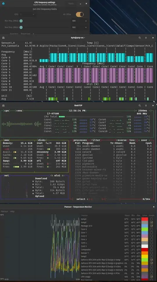

Here is my temp curve, even at idle at 800mhz, on the latest bios 1.14: enter image description here
As you can see at the bottom of the image, my temp just swings up and down. At the top of those swings the fan turns on to 'high'/full blast 4700rpm, at the bottom, the fan turns off to 0rpm. Extremely irritating. And identical to what I experienced on bios 1.10.
later update: on this laptop, my problem was using external monitors via the hdmi and miniDP port--doing this causes my temps to go literally 40+ degrees celsius higher, both in linux and windows, seemingly an nvidia driver issue. connecting my external monitors via a usb-c to dual hdmi hub instead allows my computer to sit at 47c with no fans on, at idle after a clean boot.
