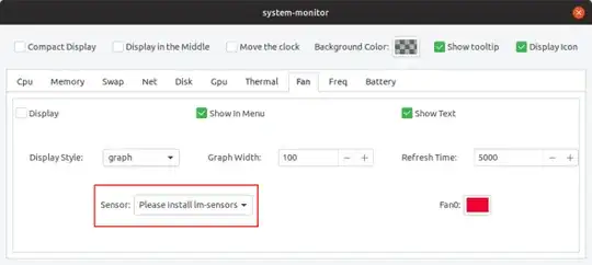

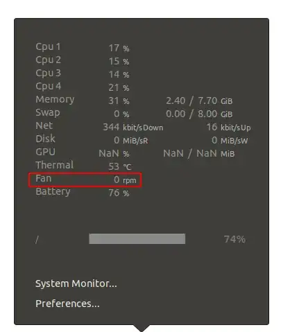

I have HP Spectre 13 x360 Laptop I cannot see or control my fan speed
Thermal show lm-sensors
(lm-sensors is installed)

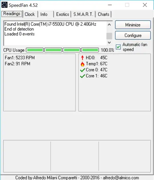

As I can in Windows using a program called SpeedFan.
Here is the it's execution log:
Win9x:NO  64Bit:YES  GiveIO:NO  SpeedFan:YES
I/O properly initialized
Linked ISA BUS at $0290
Scanning ISA BUS at $0290...
SuperIO Chip=SCH5027D
Found AXNS381E-256GM-B on AdvSMART
INFO : SCSI DISABLED by user or because iaStorA.sys is installed
Found Hewlett-Packard HP Spectre x360 Convertible 13
Found ACPI temperature
Found Intel(R) Core(TM) i7-5500U CPU @ 2.40GHz
End of detection
Loaded 0 events
