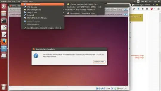

I am following this question: How to install Ubuntu on VirtualBox? and I know want to remove the .iso, but it's not the same as in that question. Here is what I see:
What I should do?
I also tried from Machine -> Settings -> Storage, where I could locate the .iso file in the Storage Tree, but the right click on it, is giving me a list with one item, Remove attachment, but it's disabled.

Go to "Devices>CD/DVD Devices>Remove disk from virtual drive" from the top bar on your screen.
If you accidentally remove it while the VM is still running off of it, you can press the host key (usually the Windows flag on the left of your keyboard) and R to reboot it.
