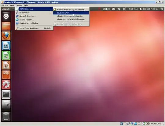

To quickly remove the installation .iso from virtual box we can select the host CD drive from the "Devices"-menu in Virtual Box Manager:
Alternatively we can also remove the .iso file in the virtual machine's settings.
For a complete guide on how to install Ubuntu in a virtual machine see:
