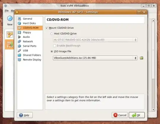

You can't mount CD/DVD image file via virtual machine settings:
Just mount the Ubuntu iso file there, and restart your virtual machine. If it's still not booting from the Live CD, check the boot order of your virtual machine.
