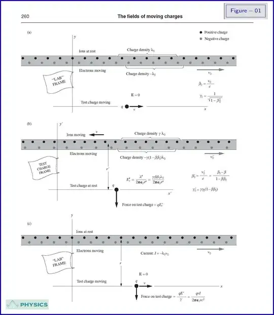

I post below the Figure 5.22 and a paragraph extracted from the book $''$Electricity and Magnetism$''$ by Edward M. Purcell & David J. Morin, 3rd Edition.
$\hebl$
Figure 5.22. A test charge $\:q\:$ moving parallel to a current in a wire. (a) In the lab frame, the wire, in which the positive charges are fixed, is at rest. The current consists of electrons moving to the right with speed $\:\nu_0$. The net charge on the wire is zero. There is no electric field outside the wire. (b) In a frame in which the test charge is at rest, the positive ions are moving to the left with speed $\:\nu\:$, and the electrons are moving to the right with speed $\:\nu'_0$. The linear density of positive charge is greater than the linear density of negative charge. The wire appears positively charged, with an external field $\:E'_r$, which causes a force $\:qE'_r$ on the stationary test charge $\:q$. (c) That force transformed back to the lab frame has the magnitude $\:qE'_r/\gamma$, which is proportional to the product of the speed $\:\nu\:$ of the test charge and the current in the wire, $\m \lambda_0\nu_0$.
$\hebl$
The case above is not exactly an answer to your question. But it gives some hints :
(1) First, since you suppose that the stationary charge in the lab system doesn't feel electric force, $(\mathbf E\e\bl0)$, the wire must have zero net charge, so we must have its configuration as in (a) of the Figure-01, that is ions at rest with linear charge density $\:\lambda_0\:$ and electrons with linear charge density $\:\m\lambda_0\:$ moving to the right with velocity $\:\nu_0\e v_d$. The current of moving electrons produces a magnetic field $\:\mathbf B\neq\bl0\:$ but zero magnetic force $\:\mathbf u_q\x\mathbf B\e\bl0\:$ on the stationary charge $q\:(\mathbf u_q\e\bl0)$. So, in the lab frame we have zero Lorentz force \begin{equation} \mathbf f\e q\plr{\mathbf E\p\mathbf u_q\x\mathbf B}\e\bl0 \tl{01} \end{equation}
(2) Second, in a frame moving to the right the ions are moving to the left and the linear density of positive charge is greater than the linear density of negative charge. The wire appears positively charged, with an external electric field $\:\mathbf E'\neq\bl0$, which causes an electric force $\:q\mathbf E'\:$ on the test charge $\:q$. This electric force is compensated by the magnetic force $\:q\plr{\mathbf u'_q\x\mathbf B'}$ on the moving charge $\:q$. So, in the moving to the right frame we have also zero Lorentz force \begin{equation} \mathbf f'\e q\plr{\mathbf E'\p\mathbf u'_q\x\mathbf B'}\e\bl0 \tl{02} \end{equation} A first quick proof of equation \eqref{02} is based on the Lorentz transformation of the electromagnetic field, see the Figure and equations (04a),(04b) in my answer therein Is it a typo in David Tong's derivation of spin-orbit interaction? repeated herein for convenience \begin{align} \mathbf E' & \e\gamma \mathbf E\m\dfrac{\gamma^2}{c^2 \plr{\gamma\p1}}\plr{\mathbf E\bl\cdot \bl\upsilon}\bl\upsilon\,\p\,\gamma\plr{\bl\upsilon\x\mathbf B} \tl{03a}\\ \mathbf B' & \e\gamma \mathbf B\m\dfrac{\gamma^2}{c^2 \plr{\gamma\p1}}\plr{\mathbf B\bl\cdot \bl\upsilon}\bl\upsilon\,\m\,\dfrac{\gamma}{c^2}\plr{\bl\upsilon\x\mathbf E} \tl{03b} \end{align} If at a point in the unprimed system (lab system) we have $\:\mathbf E\e\bl0\:$ then in the primed system moving with velocity $\:\bl\upsilon$ \begin{equation} \mathbf E' \e\bl\upsilon\x\mathbf B' \tl{04} \end{equation} see equation (08) and its proof in aforementioned linked answer. But in the new frame we have for the velocity $\:\mathbf u'_q\:$ of the test charge \begin{equation} \mathbf u'_q \e \m\bl\upsilon \tl{05} \end{equation} Equations \eqref{04},\eqref{05} imply equation \eqref{02}.
Note that based on the Lorentz transformation of the electromagnetic field, equations \eqref{03a} & \eqref{03b}, the Lorentz 3-vector force applied on a point charge $\:q\:$ moving with velocity $\:\mathbf u\:$, that is \begin{equation} \mathbf f\e q\plr{\mathbf E\p\mathbf u\x\mathbf B} \tl{06} \end{equation} under a Lorentz boost with velocity $\:\bl\upsilon\:$ is transformed as follows \begin{equation} \mathbf f'\e \dfrac{\mathbf f\p\dfrac{\gamma^2}{c^2 \plr{\gamma\p 1}}\plr{\mathbf f\bl\cdot \bl\upsilon}\bl\upsilon\m\gamma \bl\upsilon\plr{\dfrac{\mathbf f\bl\cdot\mathbf u}{c^{2}}}}{\gamma \plr{1\m\dfrac{\bl\upsilon\bl\cdot\mathbf u}{c^{2}\vphantom{\tfrac{a}{b}}}}} \tl{07} \end{equation} see equation (11) in my answer therein Are magnetic fields just modified relativistic electric fields?. So, if $\:\mathbf f\e\bl 0\:$ in an inertial frame $\:\rm S\:$ then $\:\mathbf f'\e\bl 0\:$ in any other inertial $\:\rm S'$.

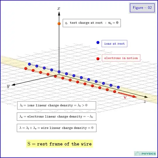

This will be done in the following for our case of the infinite straight wire. We will determine the electromagnetic field $\:\plr{\mb E,\mb B}\:$ in the inertial frame $\:\mr S$, the rest frame of the wire and the charge $\:q$, from the distribution of electric charges and electric currents directly by the Maxwell equations. Using a Lorentz boost transformation, equations \eqref{03a} & \eqref{03b}, we will determine the electromagnetic field $\:\plr{\mb E',\mb B'}\:$ in an inertial frame $\:\mr S'\:$ moving in the direction of the straight wire. By Lorentz Contraction and relativistic addition of velocities we will interpret the results determining the distribution of electric charges and electric currents in the frame $\:\mr S'$.
In Figure-02 we have an infinitely long wire with :
(1) ions of linear charge density $\:\lambda_{\bf i}\e\lambda_0\gr 0\:$ at rest so producing zero electric current $\:\mb I_{\bf i}\e\mr I_{\bf i}\mb e_{\bl z}\e\bl0\:$ and
(2) electrons of linear charge density $\:\lambda_{\bf e}\e\m\lambda_0\:$ in motion with velocity $\:\mb v\e \mr v \,\mb e_{\bl z} , \mr v \bl\in \plr{\m c,\p c}$ so producing electric current $\:\mb I_{\bf e}\e\mr I_{\bf e}\mb e_{\bl z}\e\lambda_{\bf e}\,\mb v\e \m\lambda_0\mr v \,\mb e_{\bl z}$.
So in the wire we have :
(a) zero linear charge density $\:\lambda\e\lambda_{\bf i}\p\lambda_{\bf e}\e0\:$ and
(b) electric current $\:\mb I\e \mb I_{\bf i}\p\mb I_{\bf e}\e \m\lambda_0\mr v \,\mb e_{\bl z}$.

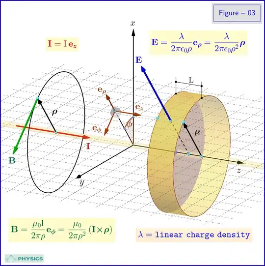

Although in many textbooks and the web we give in Figure-03 the electromagnetic field $\:\plr{\mb E,\mb B}\:$ produced by an infinitely long straight wire with constant uniform linear charge density $\:\lambda\:$ and constant electric current $\:\mb I\e \mr I\,\mb e_{\bl z}$. Note that $\:\mr I\:$ is not the magnitude of the vector $\:\mb I\:$, it's a real number, that is it could take negative values. Because of the rotational around and translational along the $\:z\m$axis symmetries we use cylindrical coordinates $\:\rho,\phi,z\:$ so we have \begin{equation} \mb E\e\dfrac{\lambda}{2\pi\epsilon_0\rho}\mb e_{\bl\rho}=\dfrac{\lambda}{2\pi\epsilon_0\rho^2}\bl\rho\,,\qquad \mb B=\dfrac{\mu_0\mr I}{2\pi\rho}\mb e_{\bl\phi}\e\dfrac{\mu_0}{2\pi\rho^2}\plr{\mb I\bl{\times\rho}} \tl{A-01} \end{equation} where $\:\bl\rho\e \rho\,\mb e_{\bl\rho}\e \plr{\rho\cos\phi,\rho\sin\phi,0}$.
In equation \eqref{A-01} the magnitude of the vector $\:\mb E\:$ is determined from the Maxwell equation \begin{equation} \bl{\nabla\cdot}\mb E\e\dfrac{\varrho}{\epsilon_0}\quad \texttt{where } \varrho\e\texttt{volume charge density} \tl{A-02} \end{equation} by volume integration in a cylinder of radius $\:\rho\:$ and height $\:\mr L\:$ \begin{equation} \begin{split} \iiint\limits_V\bl{\nabla\cdot}\mb E\,\mr dV & \e\iiint\limits_V\dfrac{\varrho}{\epsilon_0}\,\mr dV\:\bl\Longrightarrow\:\iint\limits_S \mb E\bl\cdot\mr d\bl S\e\dfrac{\lambda\mr L}{\epsilon_0}\:\bl\Longrightarrow\\ \mr E\cdot 2\pi\rho \,\mr L & \e \dfrac{\lambda\mr L}{\epsilon_0}\:\bl\Longrightarrow\: \mr E\e\dfrac{\lambda}{2\pi\epsilon_0\rho}\\ \end{split} \tl{A-03} \end{equation} that is essentially by Gauss Law.
Also the magnitude of the vector $\:\mb B\:$ is determined from the Maxwell equation \begin{equation} \bl{\nabla\times}\mb B\e \mu_0 \mb j \p\dfrac{1}{c^2}\dfrac{\partial\mb E}{\partial t}\quad \texttt{where } \mb j\e\texttt{electric current density} \tl{A-04} \end{equation} by surface integration on a circular disk of radius $\:\rho\:$ (note that $\:\mb E\:$ is constant in time) \begin{equation} \begin{split} \iint\limits_S\plr{\bl{\nabla\times}\mb B}\bl\cdot\mr d\bl S & \e\iint\limits_S\mu_0 \mb j \bl\cdot\mr d\bl S\:\bl\Longrightarrow\:\oint\limits_C\mb B\bl\cdot\mr d\bl \ell\e \mu_0\,\mr I\:\bl\Longrightarrow\\ \mr B\cdot 2\pi\rho & \e\mu_0\,\mr I\:\bl\Longrightarrow\:\mr B\e\dfrac{\mu_0\mr I}{2\pi\rho} \\ \end{split} \tl{A-05} \end{equation} Note that the electromagnetic field $\:\plr{\mb E,\mb B}\:$ in equation \eqref{A-01} as derived directly from Maxwell equations is exactly (not approximately) relativistic.

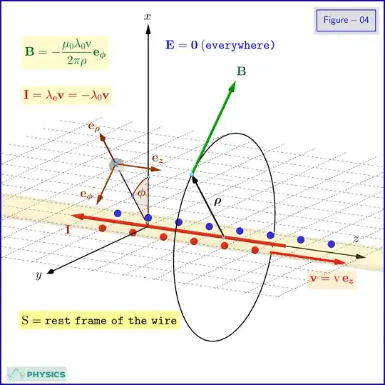

Using above general solution for our case here with zero linear electric charge density $\:\lambda\e0\:$ and electric current $\:\mb I\e \m\lambda_0\mr v \,\mb e_{\bl z}$., that is for the configuration of Figure-02, we have in the rest frame $\:\mr S\:$ of the wire \begin{equation} \mb E\e\bl 0\:(\texttt{everywhere)}\,,\qquad \mb B\e\m\dfrac{\mu_0\lambda_0\mr v}{2\pi\rho}\mb e_{\bl\phi} \tl{A-06} \end{equation} as shown in Figure-04.

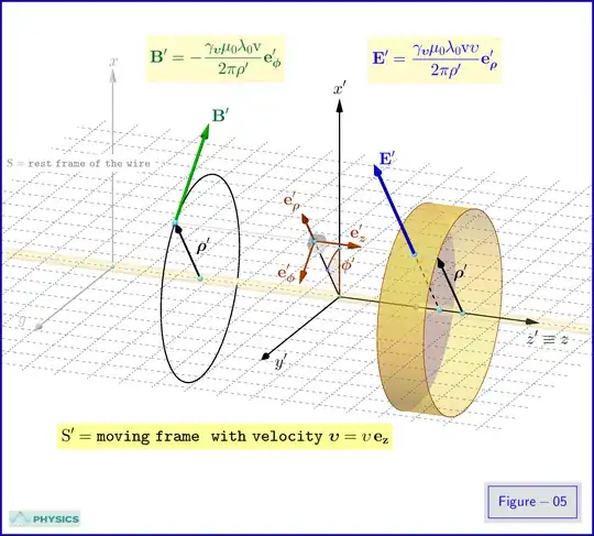

In an inertial frame $\:\mr S'\:$ moving with velocity $\:\bl\upsilon\e \upsilon\,\mb e_{\bl z}\:$ with respect to the rest frame $\:\mr S\:$ of the wire the electromagnetic field $\:\plr{\mb E',\mb B'}\:$ will be derived from that of \eqref{A-06} via the Lorentz boost transformation, equations \eqref{03a} & \eqref{03b}, that is \begin{equation} \mb E'\e\gamma_{\bl \upsilon}\plr{\bl{\upsilon\times}\mathbf B}\,,\qquad \mb B'\e\gamma_{\bl \upsilon}\mb B\qquad \texttt{ where }\gamma_{\bl \upsilon}\e 1\bigg/\sqrt{1\m\dfrac{\upsilon^2}{c^2}} \tl{A-07} \end{equation} since $\:\mb E\e\bl 0\:$ and $\:\plr{\mb B\bl{\cdot\upsilon }}\e 0$.
Inserting the expression \eqref{A-06} of $\:\mb B\:$ in \eqref{A-07} we have \begin{equation} \mb E'\e\gamma_{\bl\upsilon}\plr{\bl{\upsilon\times}\mb B}\e \m\gamma_{\bl\upsilon}\dfrac{\mu_0\lambda_0\upsilon\,\mr v}{2\pi\rho}\plr{\mb e_{\bl z}\bl\times\mb e_{\bl\phi}}\e \m\gamma_{\bl\upsilon}\dfrac{\mu_0\lambda_0\upsilon\,\mr v}{2\pi\rho'}\plr{\mb e'_{\bl z}\bl\times\mb e'_{\bl\phi}} \tl{A-08} \end{equation} so \begin{equation} \mb E'\e \dfrac{\gamma_{\bl\upsilon}\mu_0\lambda_0\upsilon\,\mr v}{2\pi\rho'}\mb e'_{\bl\rho}\,,\qquad \mb B'\e\m\dfrac{\gamma_{\bl\upsilon}\mu_0\lambda_0\mr v}{2\pi\rho'}\mb e'_{\bl\phi} \tl{A-09} \end{equation} as shown in Figure-05.
We bring these results in expressions similar to the general solution \eqref{A-01} as follows \begin{equation} \mb E'\e\dfrac{\lambda'}{2\pi\epsilon_0\rho'}\mb e'_{\bl\rho}=\dfrac{\lambda'}{2\pi\epsilon_0\rho'^{\,2}}\bl\rho'\,,\qquad \mb B'=\dfrac{\mu_0\mr I'}{2\pi\rho'}\mb e'_{\bl\phi}\e\dfrac{\mu_0}{2\pi\rho'^{\,2}}\plr{\mb I'\bl{\times\rho'}} \tl{A-10} \end{equation} where \begin{equation} \boxed{\:\:\lambda'\e \dfrac{\gamma_{\bl\upsilon}\upsilon\,\mr v}{c^2}\lambda_0\vp\:\:}\quad \texttt{and}\quad \boxed{\:\;\mr I'\e \m\gamma_{\bl\upsilon}\lambda_0\,\mr v\e \gamma_{\bl\upsilon} \mr I\vp\:\:} \tl{A-11} \end{equation} So it looks like on the $\:z'\m$axis of the moving frame $\:\mr S'\:$ there exists a linear electric charge density $\:\lambda'\:$ that produces the electric field $\:\mb E'\:$ and an electric current $\:\mr I'\:$ that produces the magnetic field $\:\mb B'$. But how these facts are explained and especially the values of $\:\lambda', \mr I'\:$ in equation \eqref{A-11} ??? These are explained in ADDENDUM B by interpretations using the length contraction and the relativistic addition of velocities.
