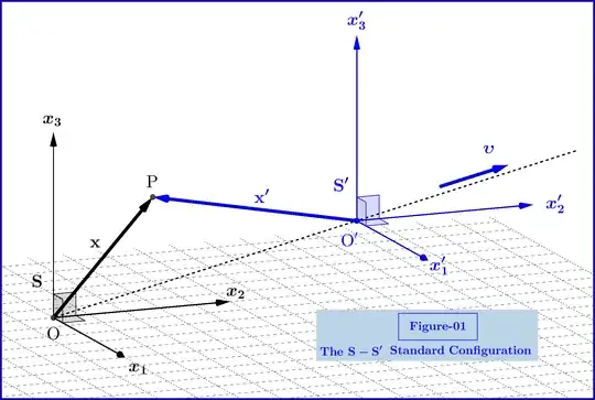

In above Figure-01 an inertial system $\:\mathrm S'\:$ is translated with respect to the inertial system $\:\mathrm S\:$ with constant velocity
\begin{align} \boldsymbol{\upsilon} & \boldsymbol{=}\left(\upsilon_{1},\upsilon_{2},\upsilon_{3}\right) \tag{02a}\label{02a}\\ \upsilon & \boldsymbol{=}\Vert \boldsymbol{\upsilon} \Vert \boldsymbol{=} \sqrt{ \upsilon^2_{1}\boldsymbol{+}\upsilon^2_{2}\boldsymbol{+}\upsilon^2_{3}}\:\in \left(0,c\right) \tag{02b}\label{02b} \end{align}
The Lorentz transformation is \begin{align} \mathbf{x}^{\boldsymbol{\prime}} & \boldsymbol{=} \mathbf{x}\boldsymbol{+} \dfrac{\gamma^2}{c^2 \left(\gamma\boldsymbol{+}1\right)}\left(\boldsymbol{\upsilon}\boldsymbol{\cdot} \mathbf{x}\right)\boldsymbol{\upsilon}\boldsymbol{-}\dfrac{\gamma\boldsymbol{\upsilon}}{c}c\,t \tag{03a}\label{03a}\\ c\,t^{\boldsymbol{\prime}} & \boldsymbol{=} \gamma\left(c\,t\boldsymbol{-} \dfrac{\boldsymbol{\upsilon}\boldsymbol{\cdot} \mathbf{x}}{c}\right) \tag{03b}\label{03b}\\ \gamma & \boldsymbol{=} \left(1\boldsymbol{-}\dfrac{\upsilon^2}{c^2}\right)^{\boldsymbol{-}\frac12} \tag{03c}\label{03c} \end{align}
For the Lorentz transformation \eqref{03a}-\eqref{03b}, the vectors $\:\mathbf{E}\:$ and $\:\mathbf{B}\:$ of the electromagnetic field are transformed as follows \begin{align} \mathbf{E}' & \boldsymbol{=}\gamma \mathbf{E}\boldsymbol{-}\dfrac{\gamma^2}{c^2 \left(\gamma\boldsymbol{+}1\right)}\left(\mathbf{E}\boldsymbol{\cdot} \boldsymbol{\upsilon}\right)\boldsymbol{\upsilon}\,\boldsymbol{+}\,\gamma\left(\boldsymbol{\upsilon}\boldsymbol{\times}\mathbf{B}\right) \tag{04a}\label{04a}\\ \mathbf{B}' & \boldsymbol{=} \gamma \mathbf{B}\boldsymbol{-}\dfrac{\gamma^2}{c^2 \left(\gamma\boldsymbol{+}1\right)}\left(\mathbf{B}\boldsymbol{\cdot} \boldsymbol{\upsilon}\right)\boldsymbol{\upsilon}\boldsymbol{-}\!\dfrac{\gamma}{c^2}\left(\boldsymbol{\upsilon}\boldsymbol{\times}\mathbf{E}\right) \tag{04b}\label{04b} \end{align} Now, if in system $\:\mathrm S\:$ we have $\:\mathbf{B}\boldsymbol{=0}$, then from \eqref{04a}-\eqref{04b} \begin{align} \mathbf{E}' & \boldsymbol{=}\gamma \mathbf{E}\boldsymbol{-}\dfrac{\gamma^2}{c^2 \left(\gamma\boldsymbol{+}1\right)}\left(\mathbf{E}\boldsymbol{\cdot} \boldsymbol{\upsilon}\right)\boldsymbol{\upsilon} \tag{05a}\label{05a}\\ \mathbf{B}' & \boldsymbol{=} \boldsymbol{-}\dfrac{\gamma}{c^2}\left(\boldsymbol{\upsilon}\boldsymbol{\times}\mathbf{E}\right) \tag{05b}\label{05b} \end{align} Equation \eqref{05b} corresponds to Tong's equation (it remains to explain the minus sign).
From equations \eqref{05a}-\eqref{05b} we have \begin{align} \mathbf{B}' & \boldsymbol{=} \boldsymbol{-}\dfrac{\gamma}{c^2}\left(\boldsymbol{\upsilon}\boldsymbol{\times}\mathbf{E}\right) \boldsymbol{=}\boldsymbol{-}\dfrac{1}{c^2}\left(\boldsymbol{\upsilon}\boldsymbol{\times}\gamma\mathbf{E}\right) \nonumber\\ & \boldsymbol{=} \boldsymbol{-}\dfrac{1}{c^2}\Biggl(\boldsymbol{\upsilon}\boldsymbol{\times}\left[\gamma \mathbf{E}\boldsymbol{-}\dfrac{\gamma^2}{c^2 \left(\gamma\boldsymbol{+}1\right)}\left(\mathbf{E}\boldsymbol{\cdot} \boldsymbol{\upsilon}\right)\boldsymbol{\upsilon}\right]\Biggr) \boldsymbol{=}\boldsymbol{-}\dfrac{1}{c^2}\left(\boldsymbol{\upsilon}\boldsymbol{\times}\mathbf{E}'\right) \nonumber \end{align} that is \begin{equation} \mathbf{B}' \boldsymbol{=}\boldsymbol{-}\dfrac{1}{c^2}\left(\boldsymbol{\upsilon}\boldsymbol{\times}\mathbf{E}'\right) \tag{06}\label{06} \end{equation} Equation \eqref{06} corresponds to Griffiths' equation.
Based on equations \eqref{04a},\eqref{04b} we have proved that \begin{equation} \mathbf{B}\boldsymbol{=0}\quad\stackrel{\eqref{04a},\eqref{04b}}{\boldsymbol{=\!=\!=\!\Longrightarrow}}\quad \mathbf{B}' \boldsymbol{+}\dfrac{1}{c^2}\left(\boldsymbol{\upsilon}\boldsymbol{\times}\mathbf{E}'\right)\boldsymbol{=0} \tag{06.1}\label{06.1} \end{equation} But we can prove the validity of its inverse \begin{equation} \mathbf{B}' \boldsymbol{+}\dfrac{1}{c^2}\left(\boldsymbol{\upsilon}\boldsymbol{\times}\mathbf{E}'\right)\boldsymbol{=0}\quad\stackrel{\eqref{04a},\eqref{04b}}{\boldsymbol{=\!=\!=\!\Longrightarrow}}\quad \mathbf{B}\boldsymbol{=0} \tag{06.2}\label{06.2} \end{equation} So these conditions are equivalent \begin{equation} \boxed{\:\:\mathbf{B}\boldsymbol{=0}\quad\stackrel{\eqref{04a},\eqref{04b}}{\boldsymbol{\Longleftarrow\!=\!=\!\Longrightarrow}}\quad \mathbf{B}' \boldsymbol{+}\dfrac{1}{c^2}\left(\boldsymbol{\upsilon}\boldsymbol{\times}\mathbf{E}'\right)\boldsymbol{=0}\:\:\vphantom{\dfrac{\tfrac{a}{b}}{\tfrac{a}{b}}}} \tag{06.3}\label{06.3} \end{equation} Equation \eqref{06.2} is valid because \begin{equation} \mathbf{B}' \boldsymbol{+}\dfrac{1}{c^2}\left(\boldsymbol{\upsilon}\boldsymbol{\times}\mathbf{E}'\right)\boldsymbol{=}\gamma^{\boldsymbol{-}1}\mathbf{B}_{\boldsymbol{\perp}} \boldsymbol{+}\mathbf{B}_{\boldsymbol{\parallel}} \tag{06.4}\label{06.4} \end{equation} where $\mathbf{B}_{\boldsymbol{\parallel}},\mathbf{B}_{\boldsymbol{\perp}}$ the components of $\mathbf{B}$ parallel and normal to the velocity vector $\boldsymbol{\upsilon}$ respectively.
