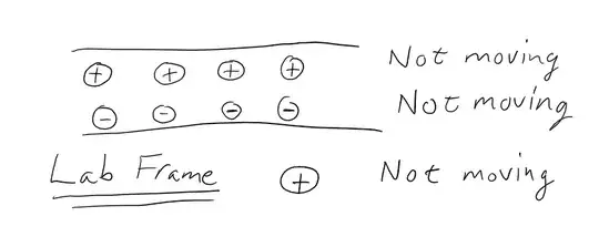

  1. Imagine you have a wire full of equally many positive and negative charges. The wire is neutral. You have a positive test charge outside of the wire. Since the wire is neutral, it experiences no electric force. Since it is not moving, it does not experience a magnetic force. Charge does not experience any force. enter image description here

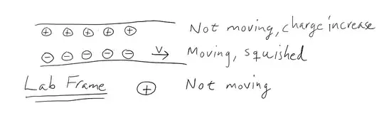

  1. You start a current, making the negative charges flow to the right. Because of special relativity and length contraction, the negative charges are "squished together" slightly in the direction they travel, compared to their length in their rest frame (the frame where they are not moving).The wire will be negatively charged, since there are more negative charges per length unit than positive ones. Compensate for this by giving the wire a positive charge so that it is still neutral in the lab frame. Your test charge experiences no electric force, since the wire is neutral. It experiences no magnetic force since it is not moving. Charge still experiencing no force. enter image description here

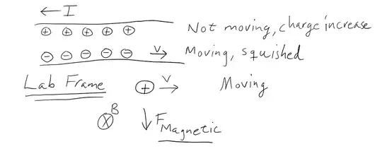

  1. Get your test charge moving, in the same direction as the current, with the same velocity v for convenience. Since there is a current going through a wire, there is a magnetic field, and we can find its direction by the right hand rule. Since our test charge is moving in a magnetic field, it will experience a force. We can find this force using F=qvB, and using the right hand rule we find it is pointing away from the wire. There is still no electric force, since the wire is neutral. When the test charge moves, it is affected by a magnetic force enter image description here

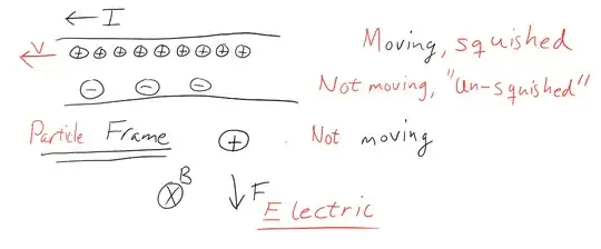

  1. Now move to the reference frame that is moving along with the test particle. Here, the negative charges are still, and the positive charges are moving to the left. So there is still a current, but since the charge is not moving in this frame, there is no magnetic force. However, the positive charges are moving in this frame, so they will squish due to length contraction. At the same time, the negative charges will "un-squish", as we are now in their rest frame. The net result is that the wire is positively charged. The test charge will be repelled by an electric force. In the particle's rest frame, there is an electric force instead. enter image description here

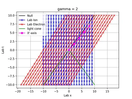

From there: just draw it in Minkowski space:
In the above figure, we see a line of stationary (blue) singly ionized atoms (heretofore: protons..it's a thought experiment after all), and matching red electrons moving along +x with $\gamma=2$. The past light cone is green, and the magenta axis shows the $x'$ axis of the moving electrons, along with their coordinate dilation:
$$ U' = U \times \sqrt{\frac{1+\beta^2}{1-\beta^2} }$$
In $S$, the wire rest frame, we have $E\propto \rho+ - |\rho_-|=0$ and $B\propto I = \rho_-\beta \equiv -\rho\beta$
Note that the graph has 1 charge per length unit, so $\rho=1$.

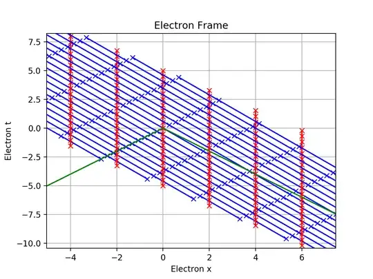

Now the electrons are at rest (vertical red lines), but their density is not 1:
$$ \rho_-' = \rho/\gamma = \frac 1 2 $$
Again: See Bell's Spaceship Paradox.
The proton density has increased to
$$ \rho'_+ = \gamma\rho = 2 $$
