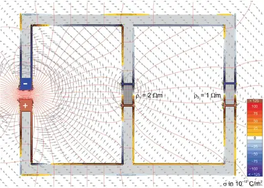

Mind you, the surface charge distributions depends on the geometry of the circuit and the position of other elements such as resistors (which develop charge at the interfaces with the conductor). Here is one simulation from the paper "A semiquantitative treatment of surface charges in DC circuits" by Rainer Muller (first link on Google)
electric field near the conductor
As you can see, sometimes the electric field impinges on the wires, sometimes it diverges, sometimes is nearly parallel. There is no 'general rule': geometry and boundary conditions can result in complicated configurations. Near the battery and near the resistors the electric field can be much greater than the electric field inside the conductors (where $E=j/\sigma$ is usually very small due to the high conductivity.
