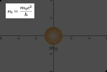

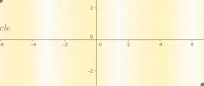

Le's go to the rest frame of the particle. Any quantity with respect to this frame will be subscripted with an $\:_{\mathrm{o}}\;$. In this frame $\;\mathrm{u}_{\mathrm{o}}=0\;$, so if we want to keep the invariance (B-04) in this limit we must have $\;\mathrm{w}_{\mathrm{o}}=\infty \;$. The wave would have wavelength $\;\lambda_{\mathrm{o}}=\infty\;$, so it would represent a uniform in space periodic in time vibration with frequency let $\;\nu_{\mathrm{o}}$. Note than this is in agreement with a "superluminal" plane phase wave, that is a time-like $\;\boldsymbol{\Omega} \equiv \left(\omega,c\mathbf{k} \right) \;$. We can find an inertial frame in which the space component of a time-like 4-vector would be zero \begin{equation} \boldsymbol{\Omega}_{\mathrm{o}} = \left(\omega_{\mathrm{o}},\mathbf{0} \right) =\left(2\pi\nu_{\mathrm{o}},\mathbf{0} \right) \tag{C-01} \end{equation}
At this point exactly we meet the de Broglie hypothesis : Since to a photon with energy $\;E\;$ there corresponds a frequency \begin{equation} \nu = \dfrac{E}{h} \tag{C-02} \end{equation} then to a massive particle with rest mass $\;m_{\mathrm{o}}\;$ or energy in its rest frame $\;E_{\mathrm{o}} =m_{\mathrm{o}}c^{2}\;$ there corresponds a wave in its rest frame with frequency \begin{equation} \nu_{\mathrm{o}} = \dfrac{E_{\mathrm{o}} }{h}= \dfrac{m_{\mathrm{o}}c^{2}}{h} \tag{C-03} \end{equation}
aaaaaaaaaaaaaa
So in a sense the particle is like to have an internal oscillation of frequency $\;\nu_{\mathrm{o}}$. In the rest frame of the particle the momentum-energy 4-vector is \begin{equation} c\mathbf{P}_{\mathrm{o}}= \left(E_{\mathrm{o}},\mathbf{0} \right) \tag{C-04} \end{equation} which combined with (C-01) and (C-03) gives \begin{equation} c\mathbf{P}_{\mathrm{o}}-\hbar \boldsymbol{\Omega}_{\mathrm{o}} = \left(0,\mathbf{0} \right) \tag{C-05} \end{equation} or more clearly \begin{equation} \left(c\mathbf{P}-\hbar \boldsymbol{\Omega}\right)_{\mathrm{o}} = \left(0,\mathbf{0} \right) \tag{C-06} \end{equation} that is there exists a frame (the rest of the particle) where the 4-vector $\; \left(c\mathbf{P}-\hbar \boldsymbol{\Omega}\right)\;$ is the zero 4-vector. So, if we apply a Lorentz Transformation to both sides of (C-06) then in any inertial frame
\begin{equation} c\mathbf{P}-\hbar \boldsymbol{\Omega} = \left(0,\mathbf{0} \right) \tag{C-07} \end{equation} since the transform of the zero 4-vector $\;\left(0,\mathbf{0} \right) \;$ is this itself. So in any frame \begin{equation} c\mathbf{P}=\hbar \boldsymbol{\Omega} \tag{C-08} \end{equation} written explicitly with the time and space components \begin{equation} \left(E,c\mathbf{p}\right)=\left(\hbar \omega,\hbar c \mathbf{k} \right) \tag{C-09} \end{equation} Equating time and space components \begin{align} E & =\hbar \omega=h\nu \tag{C-10a}\\ \mathbf{p} & = \hbar \mathbf{k} \tag{C-10b} \end{align} Equation (C-10a) is expressed as \begin{equation} \nu = \dfrac{E }{h}= \dfrac{\sqrt{\left(m_{\mathrm{o}}c^{2}\right)^{2}+\left(pc\right)^{2}}}{h}=\dfrac{\gamma m_{\mathrm{o}}c^{2}}{h} \tag{C-11} \end{equation} and (C-10b) as \begin{equation} \lambda = \dfrac{h }{p}=\dfrac{h}{\gamma m_{\mathrm{o}}v} \tag{C-12} \end{equation} so \begin{equation} \mathrm{w}=\lambda \,\nu=\dfrac{c^{2}}{v} \tag{C-13} \end{equation}
See a larger size animation of this particle and its wave here : http://i.imgur.com/hsL0OfM.gifv
