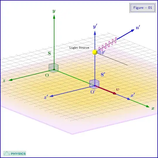

Consider that a light source at rest in frame $\:\mr S'\:$ is emitting a photon in the direction $\:\mb n'\:$ on the $x'y'\m$plane by an angle $\:\theta'\:$ with respect to $\:\bl\upsilon$. The velocity of the photon is \begin{equation} \mb u'\e c\,\mb n'\e c\plr{\cos\theta',\sin\theta',0}\e\plr{\mr u_x',\mr u_y',\mr u_z'} \tl{B-01} \end{equation} Inserting its components in equations \eqref{A-05} we find the velocity of the photon with respect to the frame $\:\mr S$ \begin{equation} \mb u\e c\,\mb n\:\e c\plr{\cos\theta\:,\sin\theta\:,0}\e\plr{\mr u_x,\mr u_y,\mr u_z} \tl{B-02} \end{equation} where \begin{equation} \boxed{\:\:\cos\theta\e\dfrac{\cos\theta'\p\beta}{1\p\beta\cos\theta'}\:, \quad \sin\theta\e\dfrac{\sin\theta'}{\gamma\plr{1\p\beta\cos\theta'}}\Vp{\dfrac{\dfrac{a}{b}}{\dfrac{a}{b}}}\:\:}\quad \texttt{(Aberration 1)} \tl{B-03} \end{equation} that is the equation for the aberration of light.

So, let again the photon emitted by the light source in its rest frame $\:\mr S'\:$ as shown in Figure-01. For its energy-momentum 4-vector we have \begin{equation} c\mb P'\e h\,\nu'\plr{1,\mr n_x',\mr n_y',\mr n_z'}\e\plr{h\,\nu',h\,\nu'\cos\theta',\,h\,\nu'\sin\theta',0} \tl{C-10} \end{equation} Its energy-momentum 4-vector in the frame $\:\mr S\:$ is \begin{equation} c\mb P\:\e h\,\nu\:\plr{1,\mr n_x,\mr n_y,\mr n_z}\e\plr{h\,\nu,h\,\nu\cos\theta,\,h\,\nu\sin\theta,0} \tl{C-11} \end{equation} Inserting these vectors in equations \eqref{A-01a}-\eqref{A-01d} in place of $\:\plr{c\,\mr dt',\mr d\mb r' }\:$ and $\:\plr{c\,\mr dt,\mr d\mb r}\:$ respectively we have in details \begin{align} h\,\nu\cos\theta &\e\gamma\plr{h\,\nu'\cos\theta'\p\beta\,h\,\nu'} \tl{C-12a}\\ h\,\nu\sin\theta &\e h\,\nu'\sin\theta' \tl{C-12b}\\ 0 &\e 0 \tl{C-12c}\\ h\,\nu &\e\gamma\plr{h\,\nu'\p \beta\,h\,\nu'\cos\theta'} \tl{C-12d} \end{align} that is \begin{align} \dfrac{\nu}{\nu'} &\e\dfrac{\gamma\,\plr{\cos\theta'\p\beta}}{\cos\theta} \tl{C-13a}\\ \dfrac{\nu}{\nu'} &\e\dfrac{\sin\theta'}{\sin\theta} \tl{C-13b}\\ \dfrac{\nu}{\nu'} &\e\gamma\plr{1\p\beta\cos\theta'} \tl{C-13c} \end{align} Equating the right hand sides firstly of equations \eqref{C-13a}, \eqref{C-13c} and secondly of equations \eqref{C-13b}, \eqref{C-13c} we get the following equations respectively \begin{equation} \cos\theta\e\dfrac{\cos\theta'\p\beta}{1\p\beta\cos\theta'}\:, \quad \sin\theta\e\dfrac{\sin\theta'}{\gamma\plr{1\p\beta\cos\theta'}} \tl{C-14} \end{equation} identical to equations \eqref{B-03}. We meet again the aberration of light as discussed in $\:\bl\S\texttt{B}$.

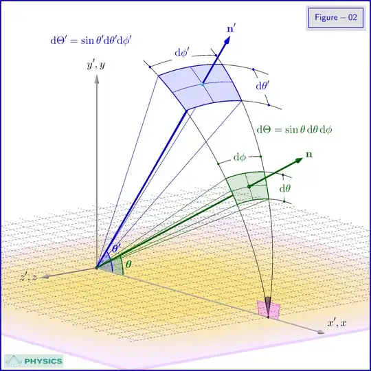

The relation between the infinitesimal solid angles $\:\mr d\Theta'\e\sin\theta'\mr d\theta'\mr d\phi'\:$ and $\:\mr d\Theta\e\sin\theta\mr d\theta\mr d\phi\:$ could be derived from equations \eqref{C-20}, the Figure-02 and the fact that for the azimuth around $\:\bl\upsilon\:$ angle $\:\phi\:$ we have $\:\mr d\phi\e\mr d\phi'\:$ \begin{equation} \dfrac{\mr d\Theta'}{\mr d\Theta}\e\dfrac{\sin\theta'\mr d\theta'\mr d\phi'}{\sin\theta\,\mr d\theta\,\mr d\phi}\e\underbrace{\plr{\dfrac{\sin\theta'}{\sin\theta}}}_{\mr D}\underbrace{\plr{\dfrac{\mr d\theta'}{\mr d\theta}}}_{\mr D}\underbrace{\plr{\dfrac{\mr d\phi'}{\mr d\phi}}}_{1}\e\mr D^2 \tl{C-21} \end{equation} that is \begin{equation} \boxed{\:\dfrac{\mr d\Theta'}{\mr d\Theta}\e \mr D^2\e\plr{\dfrac{\nu}{\nu'}}^2\Vp{\dfrac{\dfrac{a}{b}}{\dfrac{a}{b}}}\:} \tl{C-22} \end{equation}

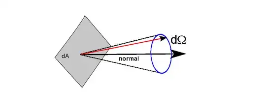

The proof of the Lorentz invariance of the scalar $\:I_\nu/\nu^3\:$ is based on the Lorentz invariance of the infinitesimal volume element in phase space. But at first we must define the Specific Intensity $\:I_\nu$. So consider a set of rays and construct the infinitesimal area $\:\mr dA\:$ normal to a given ray and look at all rays passing through area element within solid angle $\:\mr d\Omega\:$ of the given ray as shown in the Figure(1) below. enter image description here
The photon's Specific Intensity $\:I_\nu\:$ is defined to be the total energy \begin{equation} \mr dE\e h\nu\mr dN \tl{D-01} \end{equation} (where $\:\mr dN\:$ is the number of photons) that crosses this area, per unit area $\:\mr dA$, per unit time $\:\mr dt$, per unit frequency $\:\mr d\nu$, and per unit solid angle $\:\mr d\Omega$ \begin{equation} I_\nu\bl\equiv\dfrac{\mr dE}{\mr dA\,\mr dt\,\mr d\nu\,\mr d\Omega} \tl{D-02} \end{equation} (i.e., per unit everything)

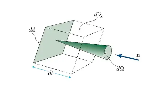

Consider that photons hit the surface area $\:\mr dA\:$ in time interval $\:\mr dt\:$ as shown in the Figure(2) below. enter image description here
Since the photons move at the speed of light $\:c$, the product of that surface area with $\:c\:$ times the time $\:\mr dt\:$ is equal to the volume they occupy at a specific moment of time: \begin{equation} \mr d\mc V_x\e\mr dA\,\mr dt \tl{D-09} \end{equation} Focus attention on a set $\:S\:$ of photons in this volume that all have nearly the same frequency $\:\nu\:$ and propagation direction $\:\mb n$. Their energies $\:E\:$ and momenta $\:\mb p\:$ are related to $\:\nu\:$ and $\:\mb n\:$ by equation \eqref{C-09}, that is \begin{equation} E\e h\nu\,,\quad \mb p\e\plr{h\nu/c}\mb n \tl{D-10} \end{equation} Their frequencies lie in a range $\:\mr d\nu\:$ centered on $\:\nu\:$, and they come from a small solid angle $\:\mr d\Omega\:$ centered on $\m\mb n$; the volume they occupy in momentum space is related to these quantities by \begin{equation} \mr d\mc V_p\e \Vlr{\mb p}^2\mr d\Omega\,\mr d \Vlr{\mb p}\e\plr{h\nu/c}^2\mr d\Omega\,\plr{h\mr d\nu/c}\e\plr{h/c}^3\nu^2\mr d\Omega\,\mr d\nu \tl{D-11} \end{equation} From the definition of specific intensity, equation \eqref{D-02}, using equations \eqref{D-01}, \eqref{D-09} and \eqref{D-11} we have \begin{equation} \boxed{\:\:\mc N\bl\equiv\dfrac{\mr dN}{\mr d^2\mc V}\e\dfrac{\mr dN}{\mr d\mc V_x\mr d\mc V_p}\e\dfrac{c^2}{h^4}\dfrac{I_\nu}{\nu^3}\Vp{\dfrac{\dfrac{a}{b}}{\dfrac{a}{b}}}\:\:} \tl{D-12} \end{equation} that is the scalar $\:I_\nu/\nu^3\:$ is except a constant identical to the distribution function $\:\mc N\:$ so by equation \eqref{D-08} a Lorentz invariant scalar.
