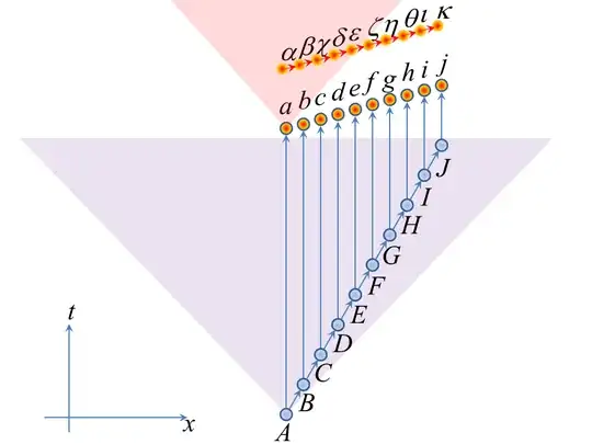

Mexican Wave
My figure above shows two versions of a "Football Wave" metachronal wave disturbance, both propagating at the same, greater than $c$ speed: the set of events $a,\,b,\,c,\,\cdots$ and $\alpha,\,\beta,\,\gamma,\,\cdots$. The former is perfectly in keeping with the principle of causality, the latter is not. In the former case, a preprogrammer visits positions on the $x$ axis one after the other, leaving instructions with protagonists at these positions to make a wave movement with their arms at a mutually agreed time in the future. These acts of "preprogramming" are the events $A,\,B,\,C,\,\cdots$. The mutually agreed times arrange for the motions of each protagonist's body (the events $a,\,b,\,c,\,\cdots$) in very swift succession to one another, begetting a metachronal wave pattern that travels at greater than speed $c$ from our frame. However, there are no direct causal links $a\rightarrow b,\,b\rightarrow c,\,\cdots$, so when a relatively uniformly moving observer sees the sequence $\cdots,\,c,\,b,\,a$ reversed in their time order, there is no contradiction: all the causal links in the whole graph $\{A,\,B,\,C,\,\cdots\}\cup\{a,\,b,\,c,\,\cdots\}$ lie within the future light cones of their forerunners and still do so even after any Lorentz transformation. However, the sequence of events $\alpha,\,\beta,\,\gamma,\,\cdots$ with putative direct causal links between them (i.e. the "whisper down the lane" signal propagation that governs most natural metachronal motion) violates causality together with Galileo's relativity postulate because some inertial observers will see these events happenning in backwards time order. Very like arguments show that the motion of a laser pointer spot across e.g. the surface of the Moon when the laser origin is on Earth, rotating in a plane at an angular speed of greater than about $45^\circ$ per second so that the spot sweeps across the Moon at greater than $300\,000{\rm km\,s^{-1}}$ is also in keeping with the principle of causality. Because the spot is moving at greater than $c$, it is seen to move in the opposite direction by some inertial observers, which fact is not a problem because there is no direct causal relationship between neighboring reflecting positions on the Moon, as for the events $a,\,b,\,c,\,\cdots$ in the figure. So, we can certainly see sequences of events (propagating "effects") in Nature travelling at greater than $c_I$, it's simply that such an observation rules out direct causal relationships between neighboring events in such a sequence. However, as we have seen with the Mexican Wave by Prior Arrangement, such a sequence does not rule out a causal relationships between the causal forerunners or antecedents of such a sequence. The causal antecedents $A,\,B,\,C,\,\cdots$ of $a,\,b,\,c,\,\cdots$ are causally related, even though there is no direct causal relationship between members of the latter sequence, which can therefore be seen evolving at a speed faster than $c_I$ without violating the causality principle. So, the observation of a sequence moving at the speed faster than the speed of light does not rule out all relationships between the sequence members, only direct causal ones. Any inertial observer, on observing a Mexican Wave moving faster than $c$, could make the null hypothesis that the motion is owing to statistically independent random jumps made by each of the Mexican Wavers. However, if there are $N$ wavers, then the likelihood of seeing them wave in order by chance alone is $2/(N!)$, so one is forced to reject the null hypothesis at pretty much any reasonable statistical significance for even a handful of wavers. The observation tells us that something is going on between them, even if it's not causal (as with any other noncausal statistical correlation).
