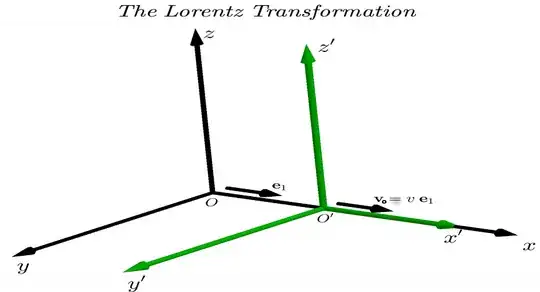

In the Figure above the so called Standard Configuration is shown. The system $\:O^{\boldsymbol{\prime}}x^{\boldsymbol{\prime}}y^{\boldsymbol{\prime}}z^{\boldsymbol{\prime}}t^{\boldsymbol{\prime}}\:$ is moving with velocity$\: \mathbf{v}_{o}=\upsilon\mathbf{e}_1\:$, $\:\upsilon \in \left(-c,+c\right)\:$, with respect to $\:Oxyzt\:$ along their common $\:x$-axis.
Using the four-vectors \begin{equation} \mathbf{R} = \begin{bmatrix} x\\ y\\ z\\ ct\\ \end{bmatrix} = \begin{bmatrix} \\ \mathbf{r}\\ \\ ct\\ \end{bmatrix} \quad , \quad \mathbf{R}^{\boldsymbol{\prime}} = \begin{bmatrix} x^{\boldsymbol{\prime}}\\ y^{\boldsymbol{\prime}}\\ z^{\boldsymbol{\prime}}\\ ct^{\boldsymbol{\prime}}\\ \end{bmatrix} = \begin{bmatrix} \\ \mathbf{r}^{\boldsymbol{\prime}}\\ \\ ct^{\boldsymbol{\prime}}\\ \end{bmatrix}\\ \tag{B-01} \end{equation} the LT for the Standard Configuration is \begin{equation} \begin{bmatrix} x^{\boldsymbol{\prime}}\\ \\ y^{\boldsymbol{\prime}}\\ \\ z^{\boldsymbol{\prime}}\\ \\ ct^{\boldsymbol{\prime}} \end{bmatrix} = \begin{bmatrix} &\gamma&0&0&-\;\dfrac{\gamma \upsilon}{c}&\\ &&&&&\\ &0&\ \ 1\ \ \ &\ \ \ 0\ \ &0&\\ &&&&&\\ &0&0&1&0&\\ &&&&&\\ &-\;\dfrac{\gamma \upsilon}{c}&0&0&\gamma &\\ \end{bmatrix} \begin{bmatrix} x\\ \\ y\\ \\ z\\ \\ ct \end{bmatrix} \tag{B-02} \end{equation} or \begin{equation} \mathbf{R}^{'} =\ \Bbb{B}\ \mathbf{R}\\ \tag{B-03} \end{equation} where $\ \Bbb{B}\ $ is the 4x4 matrix representation of LT between the two systems in Standard Configuration \begin{equation} \Bbb{B}(\upsilon)\ =\ \begin{bmatrix} &\gamma&0&0&-\;\dfrac{\gamma \upsilon}{c}&\\ &&&&&\\ &0&\ \ 1\ \ \ &\ \ \ 0\ \ &0&\\ &&&&&\\ &0&0&1&0&\\ &&&&&\\ &-\;\dfrac{\gamma \upsilon}{c}&0&0&\gamma &\\ \end{bmatrix} \tag{B-04} \end{equation} It's clear that $\Bbb{B}$ is a function of the real scalar parameter of velocity $\upsilon$.The velocity parameter $\upsilon$ in not necessarily the norm of the velocity vector, that is non-negative. Negative values mean translation towards the negative values of the axis $Ox$.
Also $\:\gamma\:$ is the well-known factor \begin{equation} \gamma\ \stackrel{\text{def}}{\equiv} \ \left(1-\frac{\upsilon^2}{c^{2}}\right)^{-\frac{1}{2}}=\dfrac{1}{\sqrt{1-\dfrac{\upsilon^2}{c^{2}}}}\\ \tag{B-05} \end{equation}
We must note at this point that $\ \Bbb{B}\ $ has 3 main properties : (1) it's symmetric (2) its inverse is this the same with inverted $\upsilon$ and (3) it's of unit determinant :
\begin{equation} \Bbb{B}^{\rm{T}}(\upsilon)=\Bbb{B}(\upsilon)\quad, \quad \Bbb{B}^{-1}(\upsilon)=\Bbb{B}(-\upsilon)\quad, \quad \det{\Bbb{B}(\upsilon)}=1 \tag{B-06} \end{equation} In order to make the Standard Configuration more general, that is not restricted to velocities parallel to the common axis $\ Ox\equiv Ox^{'}$, we make a rotation $\;S\;$ of spatial coordinate system from $\ (x,y,z)\equiv\mathbf{r}\ $ to $\ (x_1,x_2,x_3)\equiv\mathbf{x}\ $ such that the velocity \begin{equation} \mathbf{v}_{0}=(\upsilon,0,0)=\upsilon(1,0,0)=\upsilon \mathbf{e}_{1} \tag{B-07} \end{equation} of system $\ O^{'}x^{'}y^{'}z^{'}\ $ relatively to $\ Oxyz\ $, to be transformed to \begin{equation} \mathbf{v}=(\upsilon_1,\upsilon_2,\upsilon_3)=\upsilon(n_1,n_2,n_3)=\upsilon \mathbf{n} \tag{B-08} \end{equation} where $\ \mathbf{n}=(n_1,n_2,n_3)\ $ is a unit vector. In order to keep the spatial coordinate system right orthonormal we choose any orthogonal matrix $\;S\;$ with positive unit determinant : \begin{equation} S=\begin{bmatrix} &s_{11}&s_{12}&s_{13}&\\ &s_{21}&s_{22}&s_{23}&\\ &s_{31}&s_{32}&s_{33}& \end{bmatrix} \tag{B-09} \end{equation}

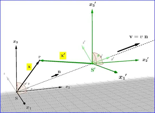

Since we must have \begin{equation} S\mathbf{v}_{0}=\mathbf{v} \tag{B-10} \end{equation} or \begin{equation} \begin{bmatrix} &s_{11}&s_{12}&s_{13}&\\ &s_{21}&s_{22}&s_{23}&\\ &s_{31}&s_{32}&s_{33}& \end{bmatrix} \begin{bmatrix} &1&\\ &0&\\ &0& \end{bmatrix} = \begin{bmatrix} &n_1&\\ &n_2&\\ &n_3& \end{bmatrix} \tag{B-11} \end{equation} then \begin{equation} \begin{bmatrix} &s_{11}&\\ &s_{21}&\\ &s_{31}& \end{bmatrix} = \begin{bmatrix} &n_1&\\ &n_2&\\ &n_3& \end{bmatrix} \tag{B-12} \end{equation} The rows or columns of $\;S\;$ constitute a right orthonormal system, so \begin{equation} SS^{\rm{T}}=I=S^{\rm{T}}S \tag{B-13} \end{equation} and \begin{equation} S^{-1}=S^{\rm{T}} \tag{B-14} \end{equation} The $4\times4$ matrix is in block form \begin{equation} \Bbb{S}\ =\ \begin{bmatrix} & S &\mathbf{0}&\\ &&&\\ &\mathbf{0}^{\rm{T}}&\ \ 1\ \ \ &\\ \end{bmatrix} \tag{B-15} \end{equation} where, as in definitions (A-05) \begin{equation} \boldsymbol{0}= \begin{bmatrix} 0\\ 0 \\ 0 \end{bmatrix} \quad , \quad \boldsymbol{0}^{\rm{T}}= \begin{bmatrix} 0&0&0 \end{bmatrix} \tag{A-05} \end{equation}
Now, if in the accented system $\ O^{\boldsymbol{\prime}}x^{\boldsymbol{\prime}}y^{\boldsymbol{\prime}}z^{\boldsymbol{\prime}}\ $ the same exactly spatial transformation $\;S\;$ is used from $\ (x^{\boldsymbol{\prime}},y^{\boldsymbol{\prime}},z^{\boldsymbol{\prime}})\equiv\mathbf{r}\ $ to $\ (x_1^{\boldsymbol{\prime}},x_2^{\boldsymbol{\prime}},x_3^{\boldsymbol{\prime}})\equiv\mathbf{x}^{\boldsymbol{\prime}}\ $ then
\begin{equation} \mathbf{X} = \begin{bmatrix} x_1\\ x_2\\ x_3\\ x_4 \end{bmatrix} = \begin{bmatrix} \\ \mathbf{x}\\ \\ ct \end{bmatrix} =\Bbb{S}\mathbf{R}= \begin{bmatrix} \\ S\mathbf{r}\\ \\\ ct \end{bmatrix} \quad , \quad \mathbf{X}^{\boldsymbol{\prime}} = \begin{bmatrix} x_1^{\boldsymbol{\prime}}\\ x_2^{\boldsymbol{\prime}}\\ x_3^{\boldsymbol{\prime}}\\ x_4^{\boldsymbol{\prime}} \end{bmatrix} = \begin{bmatrix} \\ \mathbf{x}^{\boldsymbol{\prime}}\\ \\ ct^{\boldsymbol{\prime}}\\ \end{bmatrix} =\Bbb{A}\mathbf{R}^{\boldsymbol{\prime}}= \begin{bmatrix} \\ S\mathbf{r}^{\boldsymbol{\prime}}\\ \\ ct^{\boldsymbol{\prime}}\\ \end{bmatrix}\\ \tag{B-16} \end{equation} and we proceed to find the transformation between the new coordinates, $\;\mathbf{X}\;$ and $\;\mathbf{X}^{\boldsymbol{\prime}}\;$, from the relation between $\;\mathbf{R}\;$ and $\;\mathbf{R}^{\boldsymbol{\prime}}\;$, see equations (B-02) to (B-04):
\begin{eqnarray} \mathbf{R}^{\boldsymbol{\prime}} &=& \Bbb{B}\mathbf{R} \nonumber\\ \Bbb{S}\mathbf{R}^{\boldsymbol{\prime}} &=& \Bbb{S}\Bbb{B}\mathbf{R} \nonumber\\ \Bbb{S}\mathbf{R}^{\boldsymbol{\prime}} &=& \left[\Bbb{S}\Bbb{B}\Bbb{S}^{-1}\right]\left[\Bbb{S}\mathbf{R}\right] \nonumber\\ \mathbf{X}^{\boldsymbol{\prime}} &=& \left[\Bbb{S}\Bbb{B}\Bbb{S}^{-1}\right]\mathbf{X} \nonumber\\ \mathbf{X}^{\boldsymbol{\prime}} &=& \Bbb{L}\mathbf{X} \tag{B-17} \end{eqnarray} So the new matrix for the Lorentz Transformation is \begin{equation} \Bbb{L}=\Bbb{S}\Bbb{B}\Bbb{S}^{-1}\\ \tag{B-18} \end{equation} and by equations (B-13)and (B-14) \begin{equation} \Bbb{S}^{-1}= \begin{bmatrix} &S^{-1}\ &\boldsymbol{0}&\\ &&&\\ &\boldsymbol{0}^{\rm{T}}& 1 &\\ \end{bmatrix} = \begin{bmatrix} & S^{\rm{T}}&\boldsymbol{0}&\\ &&&\\ &\boldsymbol{0}^{\rm{T}}& 1 &\\ \end{bmatrix} = \Bbb{S}^{\rm{T}} \tag{B-19} \end{equation} The $4\times4$ matrix $\;\Bbb{B}\;$ defined by equation (B-04) is expressed in block form \begin{equation} \Bbb{B} = \begin{bmatrix} &B&-\;\dfrac{\gamma \mathbf{v}_{0}}{c}&\\ &&&\\ &-\;\dfrac{\gamma \mathbf{v}_{0}^{\rm{T}}}{c}&\ \ \gamma\ \ \ &\\ \end{bmatrix} \tag{B-20} \end{equation} where $\;B\;$ is the $3\times3$ matrix
\begin{equation} B= \begin{bmatrix} &\gamma&0&0&\\ &0&1&0&\\ &0&0&1&\\ \end{bmatrix} \tag{B-21} \end{equation} and \begin{equation} \mathbf{v}_{0}\equiv \begin{bmatrix} \upsilon\\ 0\\ 0\\ \end{bmatrix} =\upsilon \mathbf{e}_{1} \ \ \text{ with transpose }\ \ \mathbf{v}_{0}^{\rm{T}}= \begin{bmatrix} \ \ \upsilon\ \ 0\ \ 0\ \\ \end{bmatrix} \tag{B-22} \end{equation} So \begin{eqnarray} \Bbb{L}&=& \Bbb{S}\Bbb{B}\Bbb{S}^{-1}=\Bbb{S}\Bbb{B}\Bbb{S}^{\rm{T}} \nonumber\\ && \nonumber\\ &=& \begin{bmatrix} &S&\hspace{5mm}\mathbf{0}&\\ &\mathbf{0}^{\rm{T}}&\hspace{5mm}1&\\ \end{bmatrix} \begin{bmatrix} &B&-\;\dfrac{\gamma \mathbf{v}_{0}}{c}&\\ &&&\\ &-\;\dfrac{\gamma \mathbf{v}_{0}^{\rm{T}}}{c}&\ \ \gamma\ \ \ &\\ \end{bmatrix} \begin{bmatrix} &S^{\rm{T}}&\hspace{5mm} \mathbf{0}&\\ &\mathbf{0}^{\rm{T}}&\hspace{5mm}1&\\ \end{bmatrix} \nonumber\\ && \nonumber\\ &=& \begin{bmatrix} &SB&-\;\dfrac{\gamma S\mathbf{v}_{0}}{c}&\\ &&&\\ &-\;\dfrac{\gamma \mathbf{v}_{0}^{\rm{T}}}{c}&\ \ \gamma\ \ \ &\\ \end{bmatrix} \begin{bmatrix} &S^{\rm{T}}& \mathbf{0}&\\ &\mathbf{0}^{\rm{T}}&1&\\ \end{bmatrix} \nonumber\\ && \nonumber\\ &=& \begin{bmatrix} &S B&-\;\dfrac{\gamma \mathbf{v}}{c}&\\ &&&\\ &-\;\dfrac{\gamma \mathbf{v}_{0}^{\rm{T}}}{c}&\ \ \gamma\ \ \ &\\ \end{bmatrix} \begin{bmatrix} &S^{\rm{T}}& \mathbf{0}&\\ &\mathbf{0}^{\rm{T}}&1&\\ \end{bmatrix} \nonumber\\ && \nonumber\\ &=& \begin{bmatrix} &SBS^{\rm{T}}&-\;\dfrac{\gamma \mathbf{v}}{c}&\\ &&&\\ &-\;\dfrac{\gamma \mathbf{v}^{\rm{T}}}{c}&\ \ \gamma\ \ \ &\\ \end{bmatrix} \nonumber \end{eqnarray} that is \begin{equation} \Bbb{L}= \begin{bmatrix} &SBS^{\rm{T}}&-\;\dfrac{\gamma \mathbf{v}}{c}&\\ &&&\\ &-\;\dfrac{\gamma \mathbf{v}^{\rm{T}}}{c}&\ \ \gamma\ \ \ &\\ \end{bmatrix} \tag{B-23} \end{equation}
For the $3\times3$ matrix $\;SBS^{\rm{T}}\;$ we have \begin{equation} \begin{split} SBS^{T}& \quad = \quad \begin{bmatrix} &s_{11}&s_{12}&s_{13}&\\ &s_{21}&s_{22}&s_{23}&\\ &s_{31}&s_{32}&s_{33}& \end{bmatrix} \begin{bmatrix} &\gamma&0&0&\\ &0&1&0&\\ &0&0&1& \end{bmatrix} \begin{bmatrix} &s_{11}&s_{21}&s_{31}&\\ &s_{12}&s_{22}&s_{32}&\\ &s_{13}&s_{23}&s_{33}& \end{bmatrix} \\ &\\ & \quad = \quad \begin{bmatrix} &\gamma s_{11}&s_{12}&s_{13}&\\ &\gamma s_{21}&s_{22}&s_{23}&\\ &\gamma s_{31}&s_{32}&s_{33}& \end{bmatrix} \begin{bmatrix} &s_{11}&s_{21}&s_{31}&\\ &s_{12}&s_{22}&s_{32}&\\ &s_{13}&s_{23}&s_{33}& \end{bmatrix} \\ &\\ & \stackrel{(B-13)}{=} \begin{bmatrix} &1+(\gamma-1)s_{11}^{2}&\ \ (\gamma-1)s_{11}s_{21}\ \ &(\gamma-1)s_{11}s_{31}&\\ &&&&\\ &(\gamma-1)s_{21}s_{11}&\ \ 1+(\gamma-1)s_{21}^{2}\ \ &(\gamma-1)s_{21}s_{31}&\\ &&&&\\ &(\gamma-1)s_{31}s_{11}&\ \ (\gamma-1)s_{31}s_{21}\ \ &1+(\gamma-1)s_{31}^{2}& \end{bmatrix}\\ &\\ & \stackrel{(B-12)}{=} \begin{bmatrix} &1+(\gamma-1)n_1^{2}&\ \ (\gamma-1)n_1n_2\ \ &(\gamma-1)n_1n_3&\\ &&&&\\ &(\gamma-1)n_2n_1&\ \ 1+(\gamma-1)n_2^{2}\ \ &(\gamma-1)n_2n_3&\\ &&&&\\ &(\gamma-1)n_3n_1&\ \ (\gamma-1)n_3n_2\ \ &1+(\gamma-1)n_3^{2}& \end{bmatrix}\\ &\\ & \quad = \quad I+(\gamma-1) \begin{bmatrix} n_1\\ \\ n_2\\ \\ n_3 \end{bmatrix} \begin{bmatrix} n_1\ \ n_2\ \ n_3 \end{bmatrix} \quad = \quad I+(\gamma-1)\mathbf{n}\mathbf{n}^{\rm{T}} \end{split} \tag{B-24} \end{equation} and finally \begin{equation} SBA^{T}= I+(\gamma-1)\mathbf{n}\mathbf{n}^{\rm{T}} \tag{B-25} \end{equation} where \begin{equation} \mathbf{n}\equiv \begin{bmatrix} n_1\\ n_2\\ n_3\\ \end{bmatrix} \ \ \text{ with transpose }\ \ \mathbf{n}^{\rm{T}} = \begin{bmatrix} \ \ n_1\ \ n_2\ \ n_3\ \\ \end{bmatrix} \tag{B-26} \end{equation} By equation (B-23) the detailed expression of $\; \Bbb{L} \;$ is \begin{equation} \Bbb{L}(\mathbf{v})= \begin{bmatrix} &1+(\gamma-1)n_1^{2}&(\gamma-1)n_1n_2&(\gamma-1)n_1n_3&-\;\dfrac{\gamma \upsilon}{c}n_1&\\ &&&&&\\ &(\gamma-1)n_2n_1&1+(\gamma-1)n_2^{2}&(\gamma-1)n_2n_3&-\;\dfrac{\gamma \upsilon}{c}n_2&\\ &&&&&\\ &(\gamma-1)n_3n_1&(\gamma-1)n_3n_2&1+(\gamma-1)n_3^{2}&-\;\dfrac{\gamma \upsilon}{c}n_3&\\ &&&&&\\ &-\;\dfrac{\gamma \upsilon}{c}n_1&-\;\dfrac{\gamma \upsilon}{c}n_2&-\;\dfrac{\gamma \upsilon}{c}n_3&\gamma& \end{bmatrix} \tag{B-27} \end{equation} and in block form \begin{equation} \Bbb{L}(\mathbf{v})= \begin{bmatrix} &I+(\gamma-1)\mathbf{n}\mathbf{n}^{\rm{T}} &\hspace{5mm} -\;\dfrac{\gamma \mathbf{v}}{c}&\\ &&&\\ &-\;\dfrac{\gamma \mathbf{v}^{T}}{c}&\hspace{5mm}\gamma&\\ \end{bmatrix} \tag{B-28} \end{equation} where it's clear that this transformation is a function of the velocity vector $\;\mathbf{v}\;$ only, that is of the three real scalar parameters $\upsilon_1,\upsilon_2,\upsilon_3$.
Note that under this more general Lorentz Transformation the transformations of the position vector $\:\mathbf{x}\:$ and time $\:t\:$ are
\begin{equation} \mathbf{x}^{\boldsymbol{\prime}} = \mathbf{x}+(\gamma-1)(\mathbf{n}\circ \mathbf{x})\mathbf{n}-\gamma \mathbf{v}t \tag{B-29a} \end{equation} \begin{equation} t^{\boldsymbol{\prime}} = \gamma\left(t-\dfrac{\mathbf{v}\circ \mathbf{x}}{c^{2}}\right) \tag{B-29b} \end{equation} where "$\circ$" the usual inner product in $\:\mathbb{R}^{3}\:$.
In differential form \begin{equation} d\mathbf{x}^{\boldsymbol{\prime}} = d\mathbf{x}+(\gamma-1)(\mathbf{n}\circ d\mathbf{x})\mathbf{n}-\gamma \mathbf{v}dt \tag{B-30a} \end{equation} \begin{equation} dt^{\boldsymbol{\prime}} = \gamma\left(dt-\dfrac{\mathbf{v}\circ d\mathbf{x}}{c^{2}}\right) \tag{B-30b} \end{equation}
