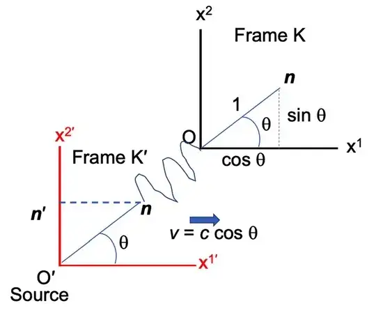

I define the inertial frame $K^\prime$ to be a boost with speed v in the $x^1$ direction of frame K. A photon is fired from a source at the origin $O^\prime$ of frame $K^\prime$, travels in the $x^1x^2$ plane, and arrives at the origin $O$ of frame K along a path that makes an angle $\theta$ with the $x^1$-axis. I set the speed of frame $K^\prime$ to be $v = c\;cos\,\theta.$
Pic of Frame <span class=$K^\prime$ offset from Frame K" />

An observer in frame $K^\prime$ sees the photon travel along the $x^{2^\prime}$-axis from $O^\prime$ to $O$, so that $\mathbf n^\prime$ is a unit vector along the $x^{2^\prime}$ axis as shown. An observer in frame K sees the photon travel diagonally and so its unit vector $\mathbf n$ is on the diagonal path as shown. So,
$$\mathbf n=(cos\theta, sin\theta, 0),\qquad \mathbf n^\prime=(0, 1, 0),$$
$$k^\mu=\frac{2\pi}{\lambda}(1,\mathbf n)=\frac{2\pi}{\lambda}(1,cos\theta,sin\theta,0),$$
$$k^{\mu^\prime}=\frac{2\pi}{\lambda^\prime}(1,\mathbf n^\prime)=\frac{2\pi}{\lambda^\prime}(1,0,1,0).$$

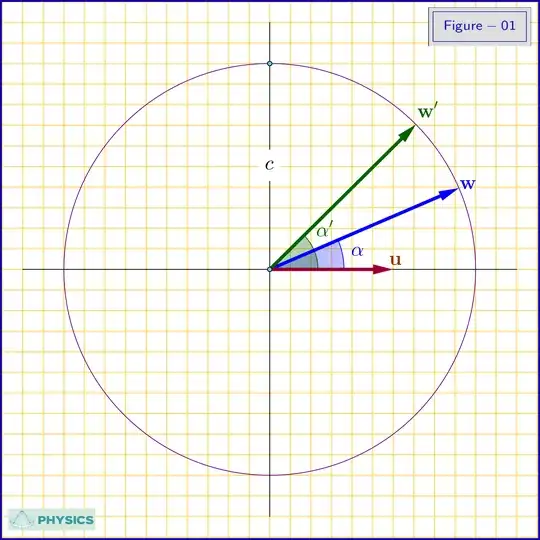

The $\,3\p 1\m$Lorentz boost transformation with arbitrary velocity $\:\mb u$ expressed in differential form is
\begin{align} \rm d\mb x' & \e \rm d\mb x\p\dfrac{\gamma^2_{\rm u}}{c^2 \plr{\gamma_{\rm u}\p 1}} \plr{\mb u\bl\cdot\rm d\mb x}\mb u\m\gamma_{\rm u}\mb u\,\mathrm dt \tl{01a}\\ \rm dt' & \e \gamma_{\rm u}\plr{\rm dt\m \dfrac{\mb u\bl\cdot\rm d\mb x}{c^2}} \tl{01b}\\ \gamma_{\rm u} & \e \plr{1\m\dfrac{\rm u^2}{c^2}}^{\m\frac12} \tl{01c} \end{align} see equations (03a),(03b),(02c) and Figure in REFERENCE-01.
Dividing equations \eqref{01a}/\eqref{01b} side-by-side we have the Lorentz transformation of velocity 3-vectors \begin{equation} \mb w'\e\dfrac{\mb w\p\dfrac{\gamma^2_{\rm u}\plr{\mb u\bl\cdot\mb w}}{c^2 \plr{\gamma_{\rm u}\p 1}}\mb u\m\gamma_{\rm u}\mb u}{\gamma_{\rm u}\plr{1\m\dfrac{\mb u\bl\cdot\mb w}{c^2}}\vphantom{\dfrac{a'}{b'}}} \tl{02} \end{equation} see equation (08) in REFERENCE-01.
If \begin{equation} \mb w\e c\,\mb n\quad \texttt{where}\quad \Vlr{\mb n}\e 1 \tl{03} \end{equation} is the velocity 3-vector of a photon, then inserting this expression in the rhs of \eqref{02} we have \begin{equation} \mb w'\e c\, \dfrac{\mb n\p\dfrac{\gamma^2_{\rm u}\plr{\mb u\bl\cdot\mb n}}{c^2 \plr{\gamma_{\rm u}\p 1}}\mb u\m\dfrac{\gamma_{\rm u}}{c}\mb u}{\gamma_{\rm u}\plr{1\m\dfrac{\mb u\bl\cdot\mb n}{c}}\vphantom{\dfrac{a'}{b'}}}\e c\, \mb n' \tl{04} \end{equation} where \begin{equation} \mb n'\e \dfrac{\mb n\p\dfrac{\gamma^2_{\rm u}\plr{\mb u\bl\cdot\mb n}}{c^2 \plr{\gamma_{\rm u}\p 1}}\mb u\m\dfrac{\gamma_{\rm u}}{c}\mb u}{\gamma_{\rm u}\plr{1\m\dfrac{\mb u\bl\cdot\mb n}{c}}\vphantom{\dfrac{a'}{b'}}} \tl{05} \end{equation} It could be proved easily that $\:\Vlr{\mb n'}\e 1 $.
Now, if we have a light signal propagating with velocity $\:\mb w\e c\,\mb n\:$ of frequency $\:\nu\:$ and wavelength $\:\lambda\:$ ($\lambda\nu\e c$) in the rest frame $\:\rm S$, then for its frequency $\:\nu'\:$ and wavelength $\:\lambda'\:$ in the moving frame $\:\rm S'\:$ we have from the relativistic Doppler shift \begin{equation} \dfrac{\nu'}{\nu}\e\dfrac{\lambda}{\lambda'}\e\gamma_{\rm u}\plr{1\m\dfrac{\mb u\bl\cdot\mb w}{c^2}\vphantom{\dfrac{a'}{b'}}}\e \gamma_{\rm u}\plr{1\m\dfrac{\mb u\bl\cdot\mb n}{c}\vphantom{\dfrac{a'}{b'}}} \tl{06} \end{equation} You could prove equation \eqref{06} following the steps of Solution 1 in REFERENCE-02.
We express equation \eqref{06} as equation \eqref{07b} and use it in \eqref{02} to produce equation \eqref{07a} so that \begin{align} \blr{\dfrac{\mb w'}{\lambda'}} & \e \blr{\dfrac{\mb w}{\lambda}\vphantom{\dfrac{a'}{b'}}}\p\dfrac{\gamma^2_{\rm u}}{c^2 \plr{\gamma_{\rm u}\p 1}} \plr{\mb u\bl\cdot\blr{\dfrac{\mb w}{\lambda}\vphantom{\dfrac{a'}{b'}}}}\mb u\m\gamma_{\rm u}\mb u\,\blr{\dfrac{1}{\lambda}\vphantom{\dfrac{a'}{b'}}} \tl{07a}\\ \blr{\dfrac{1}{\lambda'}\vphantom{\dfrac{a'}{b'}}} & \e \gamma_{\rm u}\plr{\blr{\dfrac{1}{\lambda}\vphantom{\dfrac{a'}{b'}}}\m \dfrac{\mb u}{c^2}\bl\cdot\blr{\dfrac{\mb w}{\lambda}\vphantom{\dfrac{a'}{b'}}}} \tl{07b} \end{align}
Comparing equations \eqref{07a},\eqref{07b} with \eqref{01a},\eqref{01b} respectively we conclude that the 4-vector \begin{equation} \plr{\dfrac{1}{\lambda}\vphantom{\dfrac{a'}{b'}},\dfrac{\mb w}{\lambda}\vphantom{\dfrac{a'}{b'}}} \tl{08} \end{equation} is transformed as the Lorentz 4-vector $\:\plr{\mr dt,\mr d\mb x}$.

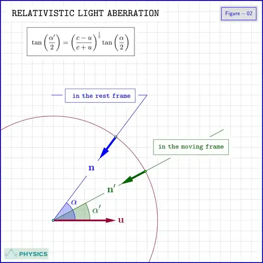

Irrelevant here but interesting : Equation \eqref{04} and Figures-01,-02 have close relation to the relativistic aberration of light.
