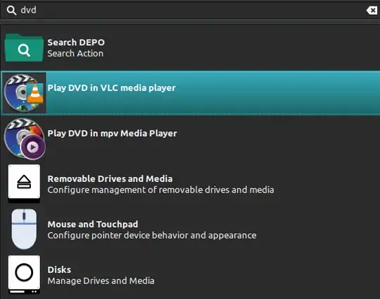

Use application launcher (Super key) with "VLC" or "DVD" to find the launcher "Play DVD in VLC media player".
I'm in Xfce, so it looks like this:

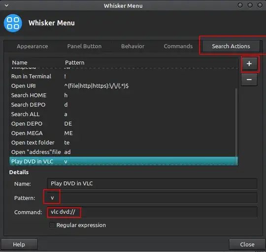

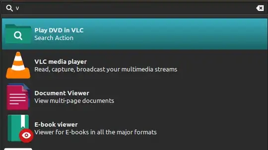

In Xfce, the Whisker Menu launcher can add a separate new "search action" that can run any command, including those discussed above:
