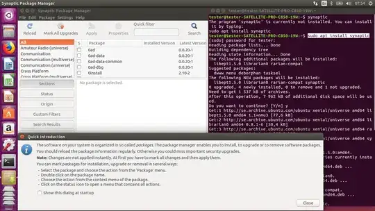

  • Use the Synaptic Package Manager
    Install it
    sudo apt install synaptic
    and start it from 'Dash', after clicking on the Ubuntu icon at the top left corner and typing syn.
    There is a learning curve, but Synaptic is reliable and powerful. Later on, when 'Ubuntu Software' starts working again, you might stay with Synaptic, because you know it and like it :-)
