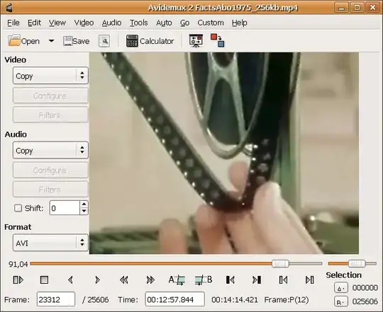

Avidemux Install avidemux
(You need to enable the multiverse repository for this to work):
Avidemux is a GTK application designed to allow you to easily resize, rescale and convert videos from one format to another. For your case it sounds perfect! According to the Sony website you just need to convert the videos to the MPEG-4 format however I can't seem to find the resizing information anywhere.
sudo apt-get install avidemux
Screenshot:
Avidemux Screenshot

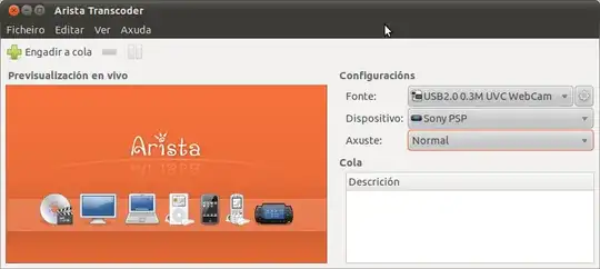

Arista TranscoderInstall Arista
As easy as it gets: just select the source (Font in the screenshot), and the target gadget and press the + button.
alt text

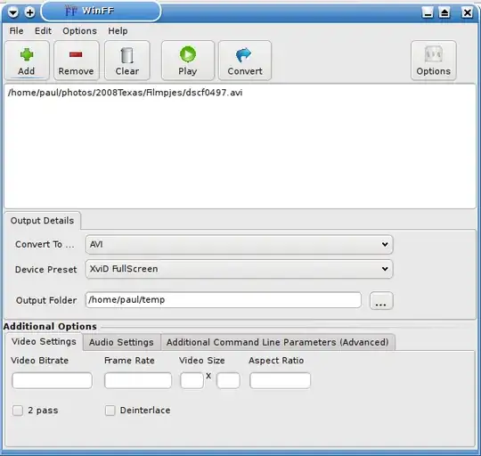

WinFF Install WinFF
WinFF is another nifty utility to convert video filetypes and sizes.
WinFF Screenshot
