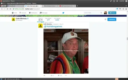

Here is an example above. It also does the same thing on other sites with other video players, but I figure this is one of the more well known ones.
Any help?
