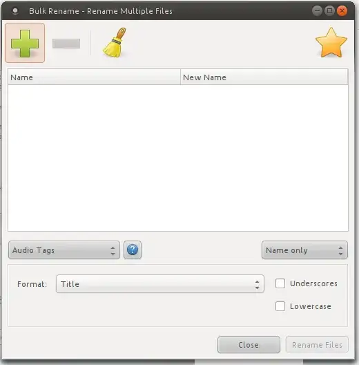

Try pyrenamer.
It's not integrated with nautilus, but it gets the job done. Here is a review.
Thunar (part of XFCE) also has a renamer that you can run separately.
Thunar bulk renamer

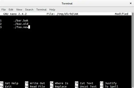

Run vidir, rename the filenames in the lines containing the filenames you wish to rename; hit CTRL+O and CTRL+X:
screenshot3
├── bar.bak
├── baz.old
└── foo.new

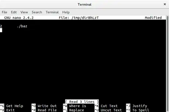

Run vidir, remove the lines containing the files you wish to delete; hit CTRL+O and CTRL+X:
screenshot2
└── baz
