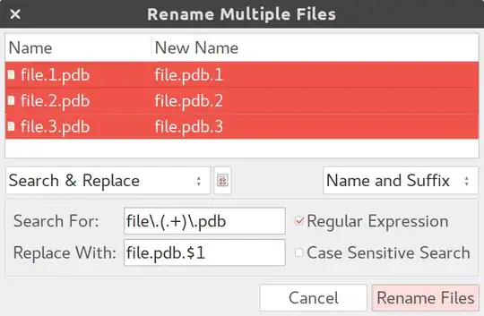

Recently nautilus, the default file manager, received a batch rename dialog. It is not yet powerful enough to do what you want. But luckily there is thunar, an alternative file manager that can be installed. With thunars rename dialog you can do what you want using the GUI.
First install thunar:
sudo apt install thunar
Start thunar, navigate to the directory that has your files. Then select all of them. Press F2.
In the dialog that opens, again, select all files. Change mode to "Search & Replace" and to "Name & Suffix". Check "Regular Expression". Now use the following as search and replace patterns:
file\.(.+)\.pdb
and
file.pdb.$1
Finally click the rename button.
The advantage of this way is that you get a visual preview of what will happen before you actually do the renaming.
