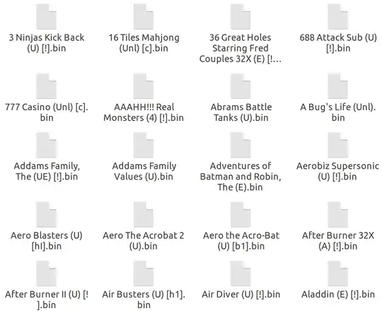

I have several files in the same folder that have one element in common in the names. How do I rename the files so that the common element in the names is deleted?
