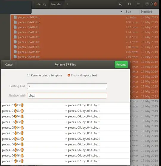

In the file browser in Ubuntu, you can select multiple files and rename them according to a pattern by just hitting F2 or right-clicking and selecting Rename.
Here I am replacing x with _by_. In your case you can replace .wav with an empty string.
rename multiple files in Ubuntu
