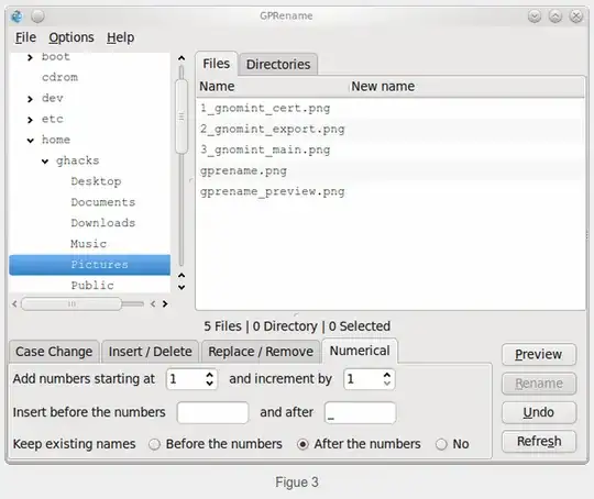

you can install GPRename, https://www.ghacks.net/2010/08/20/batch-rename-in-linux-with-gprename/ is batch renamer for both files and directories that is released under the GPL v3. It's easy to install, and even easier to use.
open terminal with CRTL+ALT+T:
sudo apt install gprename
