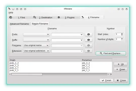

If you want to do it the gui way, here is an alternative to the very good suggestion of heemayl. You can try krename:
sudo apt-get install krename
this is as powerful as rename (with the exception that it can't be piped to in a script). enter image description here
