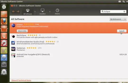

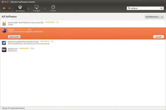

The preferred method: Software Center
  1. In Ubuntu software center select Eclipse. I installed the Extensible Tool Platform and Java IDE as well, but installing that is optional.
    eclipse in software center
  2. Enter your password in the authentication dialog. This will get you 3.7.1 inside of a package management system.

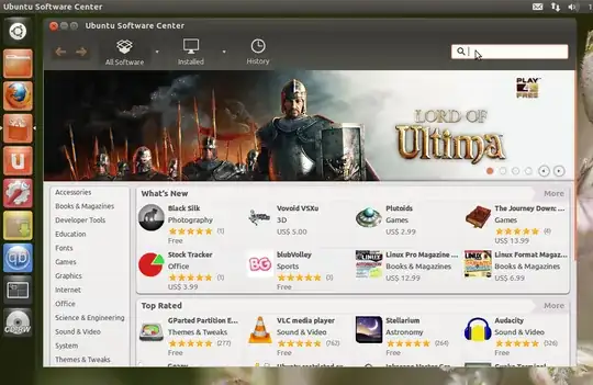

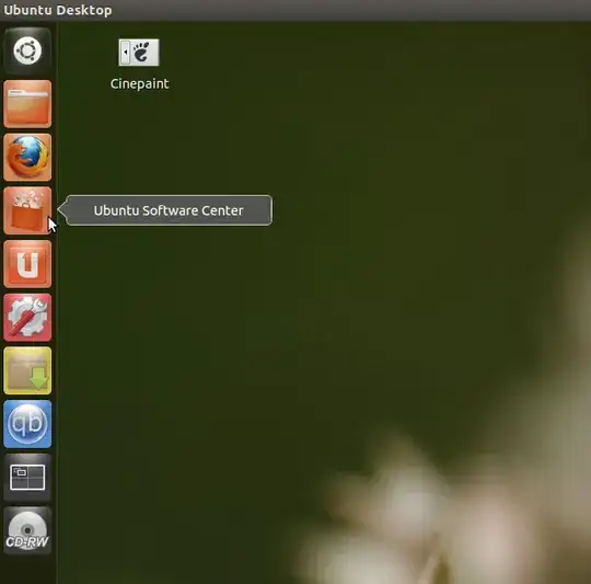

From your desktop, Click on the Ubuntu Software Center enter image description here
Once it opens do a search for Eclipse
When the search is done, you will see Eclipse listed. all you have to do is click on install, sit back and relax until the installation is done.
If you still have any questions, do not hesitate to ask.

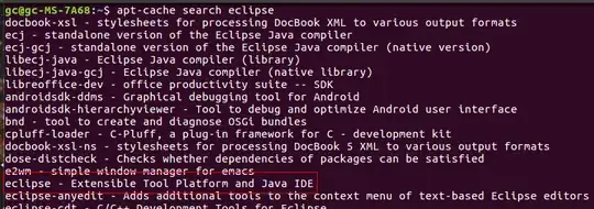

1) See what eclipse programs Ubuntu has in its Store
apt-cache search eclipse
Breakdown: search in apt-cache for any programs called “eclipse”. enter image description here
2) sudo apt-get install eclipse
Result is that Ubuntu will install Eclipse
