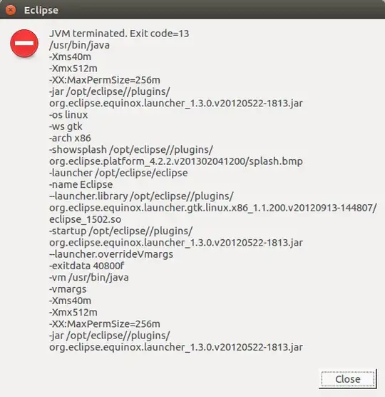

Edit: upgrading to Eclipse 4.2 gives this error:
JVM terminated. Exit code=13
/usr/bin/java
-Xms40m
-Xmx512m
-XX:MaxPermSize=256m
-jar /home/_____/eclipse/eclipse//plugins/org.eclipse.equinox.launcher_1.3.0.v20120522-1813.jar
-os linux
-ws gtk
-arch x86
-showsplash /home/_____/eclipse/eclipse//plugins/org.eclipse.platform_4.2.0.v201206081400/splash.bmp
-launcher /home/_____/eclipse/eclipse/eclipse
-name Eclipse
--launcher.library /home/_____/eclipse/eclipse//plugins/org.eclipse.equinox.launcher.gtk.linux.x86_1.1.200.v20120522-1813/eclipse_1502.so
-startup /home/_____/eclipse/eclipse//plugins/org.eclipse.equinox.launcher_1.3.0.v20120522-1813.jar
--launcher.overrideVmargs
-exitdata 18800a
-vm /usr/bin/java
-vmargs
-Xms40m
-Xmx512m
Screenshot
