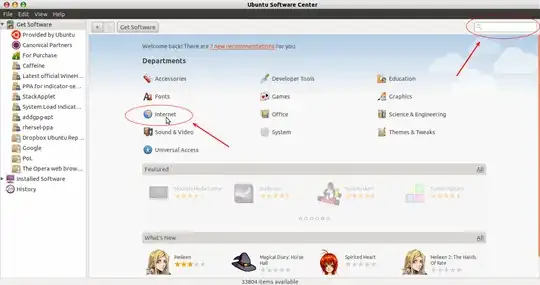

To install software within a virtual machine it is easiest to use the tools Ubuntu installs there (assuming you set it up with Internet access). Here's a list from easiest to hardest:
First Option: Ubuntu Software Center
Located in Menu->Ubuntu Software Center.If you are using Unity, open the dash and type software,then the software center will appear.
The windows of USC
Then click on the search box at the top right to search for an application(eg if you type "Ge" -> gedit will show up).
Alternately, click on a category such as Developer Tools and search for the software you want to install.
When you find it,click on the "Install" button at the top right,(or "use source" if you just installed ubuntu), enter your password for verification and wait for the software to install.
