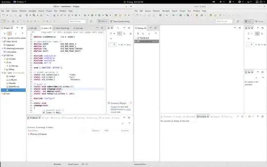

  3. During the first start of both Eclipse distributions, select a different workspace folder for each of them, eg
    workspace-cpp
    workspace-jee
    Alternatively you can change the workspace folder in Eclipse itself via File > Switch Workspace
Now you can use both distributions in parallel.
