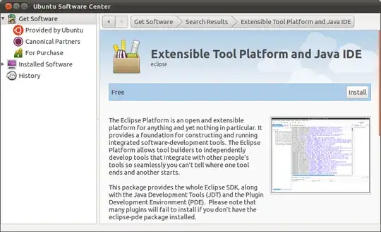

Sidenote: Eclipse is in the software center so no need to download a zip (unless you want the newest version and not the most stable one):
