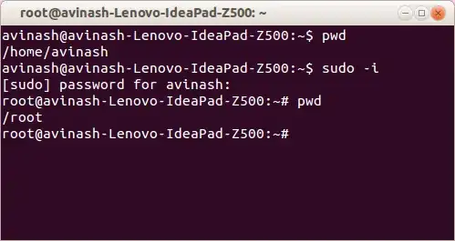

This is because after you logged in as root by running sudo -i command,the copy command cp searches for eclipse directory inside the /root folder.But you actually extracted eclipse into the /home/$USER folder.
