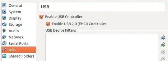

If it's a USB 2.0 device you will need to enable it in each Virtualbox image.
Make sure that your USB settings for the Ubuntu guest OS is similar to the following:
