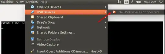

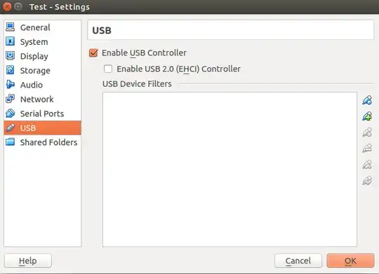

First make sure that you have Guest Additions are installed. Then, make sure that USB is enabled, and that the USB device is connected to the VM. See images below.

Try installing VirtualBox extension pack based on your VB version from this link.
After that you can see your external hard USB port in VB setting.
VirtualBox Setting --> USB
