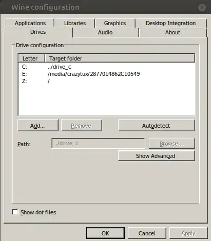

When I enter winecfg and Drives it does detect my usb as shown here:
device appears as E: under /media

  • Manually adding the USB to Wine with winecfg.

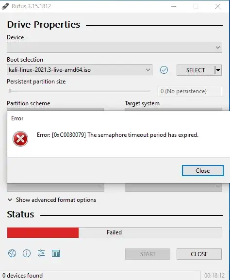

  • Installing Windows as a guest machine on VirtualBox and trying to run Rufus there. It does detect my USB but I get another error:
    the semaphore timeout period has expired
    I have tried to solve this new issue by following few solutions from this page.
    I tried adding more RAM to the guest machine but it didn't help.

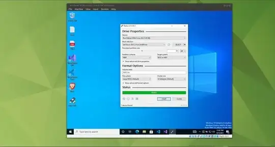

Rufus was successfully worked on Ubuntu 20.04.3 LTS Through Windows 10 VirtualBox.
rufusWorked
Dependencies:
VirtualBox Software could be installed following this article
Windows 10 OS installed on the VirtualBox could be installed following this article
Enable USB Support via the virtual Windows OS could be done following this topic
Newest Rufus software installed on the virtual windows OS could be downloaded from the official site
Now after following the above steps, your virtual windows is running and detecting your usb device you all ready to go.
The Main Problem On The VM:
"The semaphore timeout period has expired".

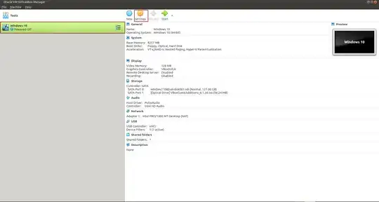

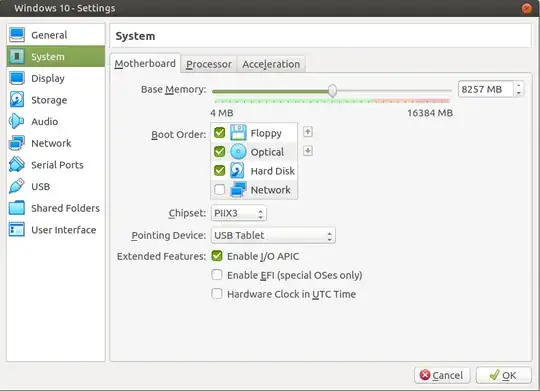

First configure your VM with enough RAM:
  • Open your VM -> Head To Settings.
firstStep
  • Head to System -> Motherboard.
secondStep
  • I recommend to assign at least 8GB RAM or (if less) half of your computer ram amount.

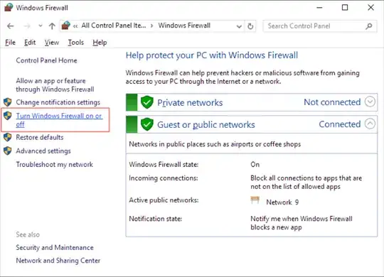

Second launch into your virtual os and disable firewall and anti-virus:

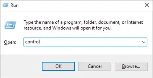

  • In Windows 10/8.1/8/7, press "Windows + R" hotkeys to bring up the "Run" box, input control to open Control Panel.
Run

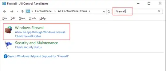

  • In the Control Panel, type firewall in the search, and click the "Windows Firewall" in the results.
controlPanel

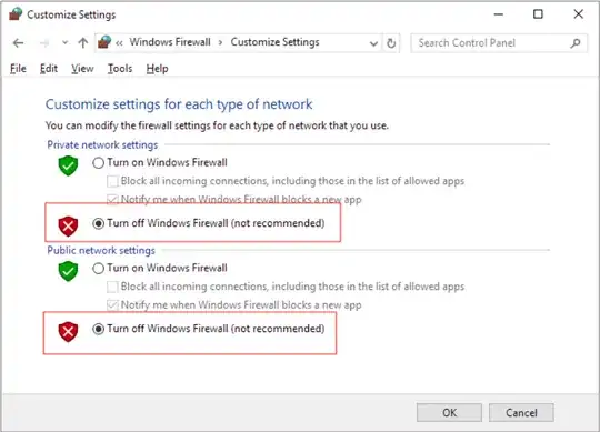

  • On the left pane, click "Turn Windows Firewall on or off".
firewall
rules

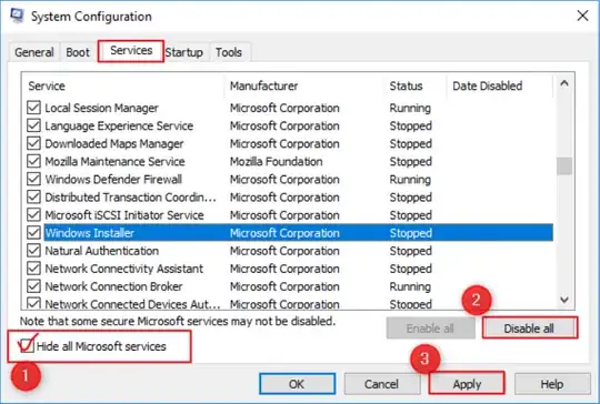

Third Perform A Clean Boot of your VM and Host:

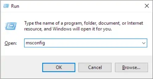

  • In Windows 10/8.1/8/7, press "Windows + R" hotkeys to bring up the "Run" box, input msconfig to open System Configuration.
msconfig
  • Switch from the default General tab to "Services", tick the box "Hide all Microsoft Services". Click "OK".
steps
  • Shut down your VM and Reboot your computer.
