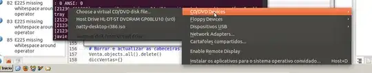

Your computer icon inside Windows will show only the virtual hardware that you have created on your virtual machine, not your real one. By default, all virtual machines are created with only one CD driver.
But you can assign any of your real drives to this one, even just iso images. You can righ click on the CD icon on the bottom rigth of the screen or use the Device Menus to do this. If you are using the seamless mode, you will find the menu on the bottom bar.
In the following screenshot sr0 is an external USB drive.
