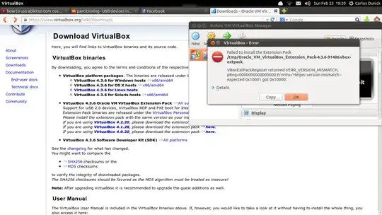

enter image description hereenter image description hereIm running Ubuntu 13.10 with Virtual Box running Windows 7. Have a shared hard drive set up between the two.
I have set up the virtual box the best I could, and have been searching endlessly on iPhone forums and windows help to find out why it wont detect my iphone or any other USB, but they give stupid answers like 'check the cord is plugged in' and 'restart you phone' or 'go into device manager' etc
Im thinking now its because im running a partition. (i understood a partition runs exactly like another operating system with everything you need and can do.
Any one encountered this problem and how did you overcome it?
P.S: Guest additions and Extension Pack installed

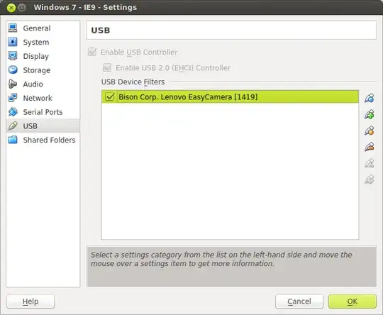

You have to set up virtual-box for USB access - Close any running Virtual Machines (as in Shutdown, not saved state), Open VirtualBox settings, by clicking settings when the right VM is selected:
You then need to tick all the boxes under USB: Look under USB in the settings
To add devices click the green '+' to the right - you might as well add all that are listed by it.

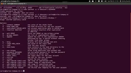

N.B. If it says you need to add your user to the vboxusers group, you need to run:
sudo usermod -a -G vboxusers USERNAME
This will add the USERNAME you specify to the vboxusers group, so you have permission to access the USB devices from inside a VM.

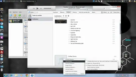

Here is a screenshot of seamless mode running iTunes and syncing my iPhone 5 :
screenshot
see at the bottom the usb devices list.
