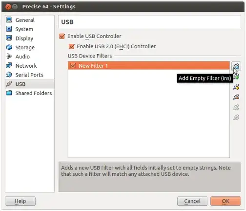

Some USB devices may need an USB-Filter rule in Virtual Box to be recognized.
This is done by adding an "empty" USB filter in the USB settings of your machine:
This may already help recognizing your device.

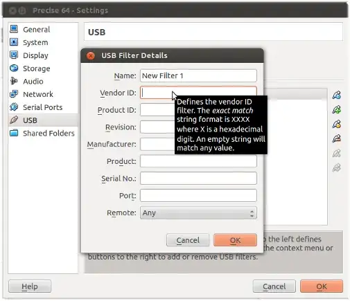

If the device was still not recognized we may further specify USB properties with a right click on the "New Filer 1". This opens a settings window with some explanatory tooltips for each entry:
The product ID and the vendor ID needed here for your webcam will be listed on
lsusb -v
Read also the Virtual Box manual for an explanation of these settings and how to get them.

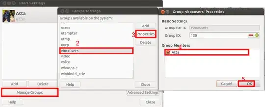

  • First install gnome-system-tools because the old users and groups GUI is not available by default on 11.10.
        sudo apt-get install gnome-system-tools
  • After the installation finished, open user and groups from the launcher.
  • Select your username click on "Manage Groups" and select "vboxusers" and click "add".
View image
  • logout/login to be able to use USB in VirtualBox.

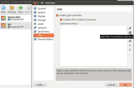

Click Add Filter From Device and select your webcam,

  1. Now if you go to Settings -> USB and check the Enable USB Controller option you should be able to access your device when you click on the Add icon.

in settings, have virtualbox "list all usb devices"
