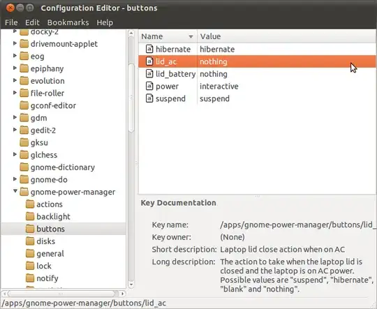

For 11.04 and earlier:
Do nothing when laptop lid is closed (helpful when an external monitor is connected):
  • Alt + F2 and enter this: gconf-editor
  • apps > gnome-power-manager > buttons
  • Set lid_ac and lid_battery to nothing
alt text
OR
1.When on AC Power, do nothing when laptop lid is closed:
gconftool-2 -t string -s /apps/gnome-power-manager/buttons/lid_ac nothing
2.When on Battery Power, do nothing when laptop lid is closed:
gconftool-2 -t string -s /apps/gnome-power-manager/buttons/lid_battery nothing

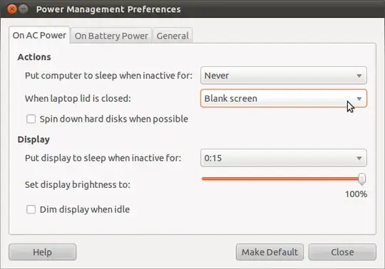

Blank screen when laptop lid is closed (preferable when no external monitor is connected):
  • System > Preferences > Power Management
  • On AC Power (On Battery Power) > Actions
  • When laptop lid is closed: Blank screen
alt text
OR
1.When on AC Power, blank screen when laptop lid is closed:
gconftool-2 -t string -s /apps/gnome-power-manager/buttons/lid_ac blank
2.When on Battery Power, blank screen when laptop lid is closed:
gconftool-2 -t string -s /apps/gnome-power-manager/buttons/lid_battery blank

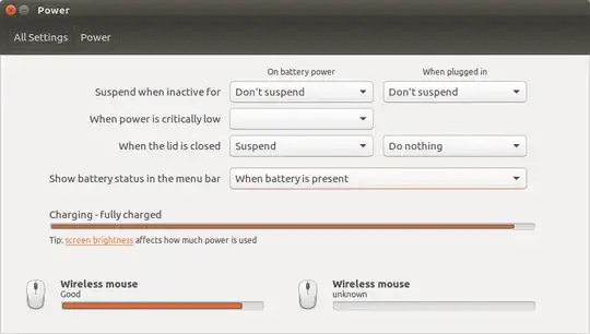

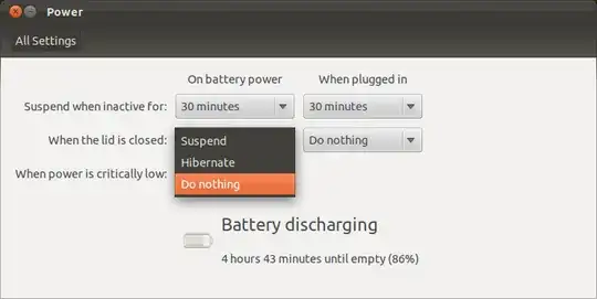

For 11.10 - 12.04:
You can select "Do Nothing" in the power settings. Open the dash (super key), search for "power" and then select the correct option in the dropdown. Note that closing the lid will actually turn off the screen though plus any external monitors:
If you move the mouse then any connected monitors will power back up with the laptop closed. This will then become the primary monitor.
This might either have been removed at some point, or it requires some hardware support which is not available in all systems: Since 16.04, I don't have 'when the lid is closed' options in power settings as there have been reports that it was not visible on Ubuntu 21.04.

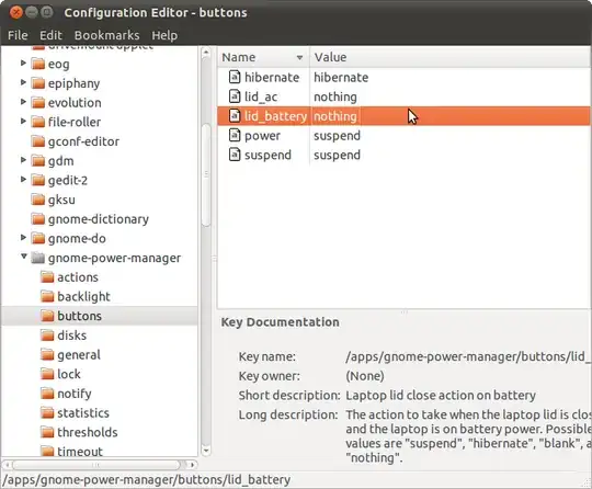

11.04 and previous versions
Copying 1st given answer from: http://ubuntuforums.org/showthread.php?t=1319921&highlight=close+laptop+lid
In a terminal (Applications-->Accessories-->Terminal), type: gconf-editor
Navigate to apps-->gnome-power-manager-->buttons and set lid_ac and/or lid_battery to "nothing" (without the quotes).

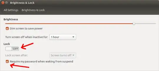

You can easily disable the lid lock feature by clicking the System Settings icon in the Launcher/Task bar, and then clicking on Brightness & Lock.
From there, you flip the Lock switch to the off position, and un-check the "Require my password when wakening from suspend." check-box.
Another thing you have to watch for if you also plan on setting up hibernation (suspend-to-disk) is whether or not your system has a large enough swap partition to actually go into hibernation. Hibernation is different than suspend, but sometimes people like to set up the hibernation feature while they are configuring suspend.
You can also go over your Power settings, so they don't suspend the system when the lid is close. You can do this in System Setting -> Power.
