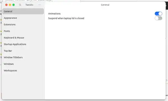

Simple GUI method
Just need to install GNOME Tweaks and it works well for Ubuntu
Open terminal and install gnome-tweaks and open it.
sudo apt update
sudo apt install gnome-tweaks
gnome-tweaks
After that you can see an option which is Suspend when laptop lid is closed. You just need to disable that option like below image.
