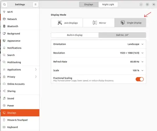

Now there is a "Single Display" option in Display Settings in GNOME.enter image description here
