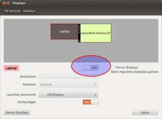

The only way I managed this: hit dash and search for displays.
Screenshot of "Displays" Window
2 things I noticed:
  • the 'off' does not get saved;
  • I still need to keep the screen physically up. Closing the lid kills the 2nd monitor too. If you do close the lid and put it back up both screens light up.
The problem is that closing the lid still shuts off my external monitor. What to do?
Found it: after the 2nd monitor turns off move the mouse or type something. The 2nd monitor will turn on.
