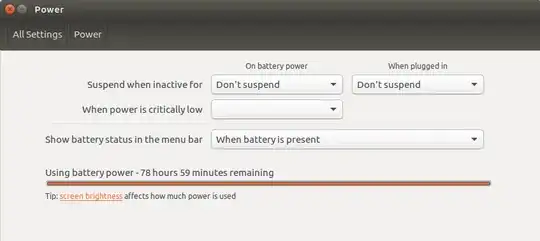

Edit : I tried HandleLidSwitch=ignore, IgnoreLid=true, dconf and it didn't work. Also I tried the Power setting but I don't have any lid option on it : enter image description here

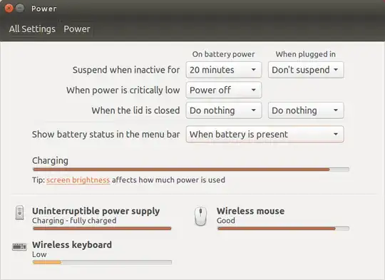

When you went into "Settings" you went to the "Brightness & Lock" screen but if you go to the "Power" screen instead you will see this:
Power do nothing on lid close
As in the screen above, set When the lid is closed to Do Nothing and that is exactly what Ubuntu does when you close the lid, ie your music continues playing as desired.
